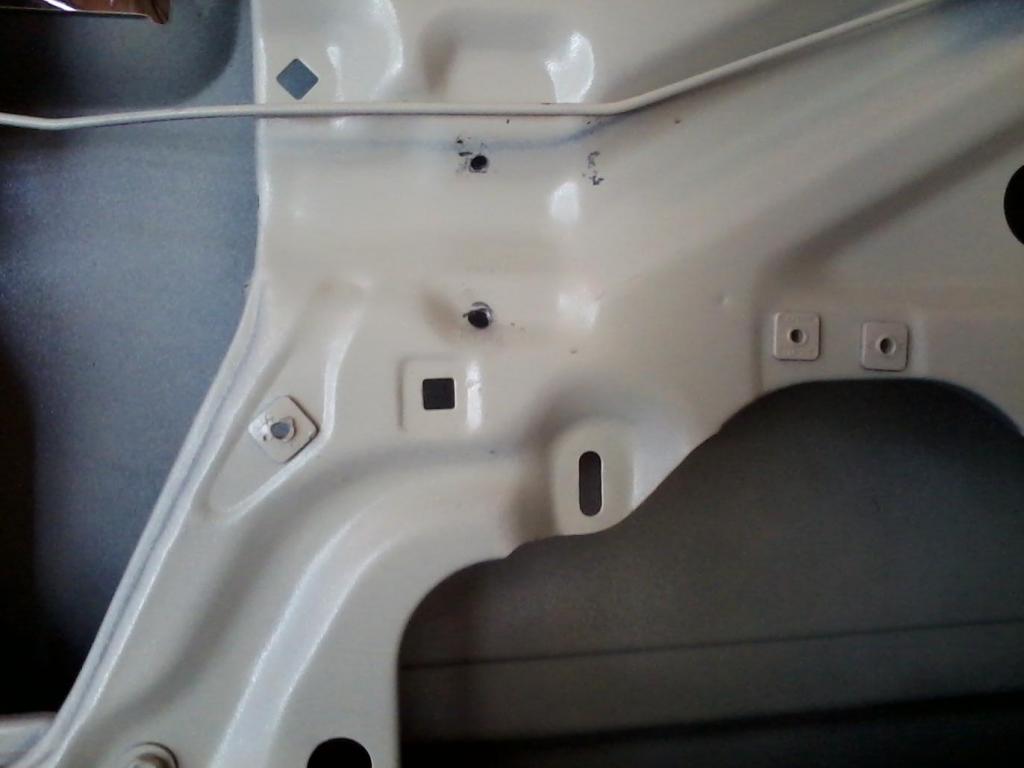

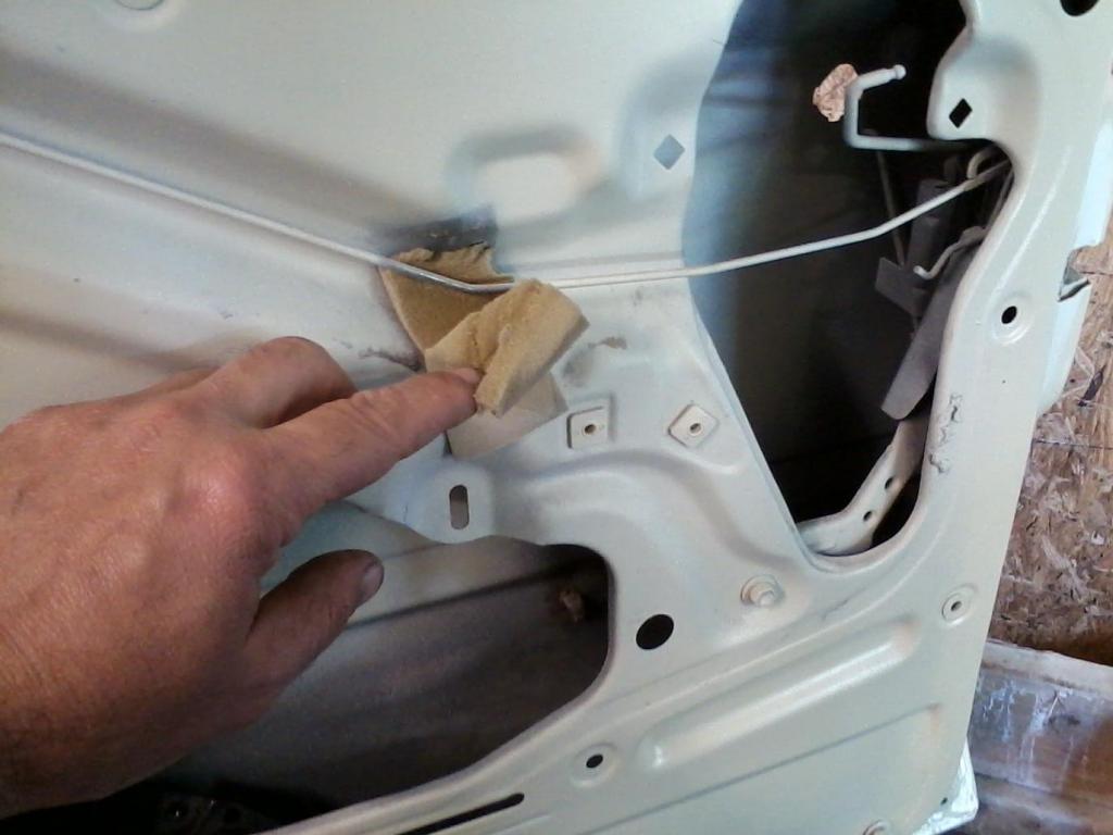

Below is from a thread of mine on how I fixed mine. I am looking for some better ways to fix this issue but this is working great for me. I can not find what is broken or damaged to cause the rod to move up out of the valley. Everything looks great when I compare the two doors. The foam my not be what actually holds the rod in but it does have cut marks where the rod sawed the foam. It will at least show where the issue is and get some different thoughts on the issue.
Copied...
This is my passenger door and it does open like it should from the inside. The drivers side does not. I was comparing the two trying to figure out why the passenger did and not the driver. I then seen this little foam. It helps hold the rod into the valley impressed in the door and that little bit makes the door open.
Here is the valley with the door handle pulled to open it and you can see where it is out of the valley.
Not the best fix in the world but is a better system then what Toyota did and it is working great now. I drilled two holes and used a ziptie.
A friend of mine and me have seen this issue several times and surprisingly I dont ever see this pop up on Yotatech or even seen a thread on it.
