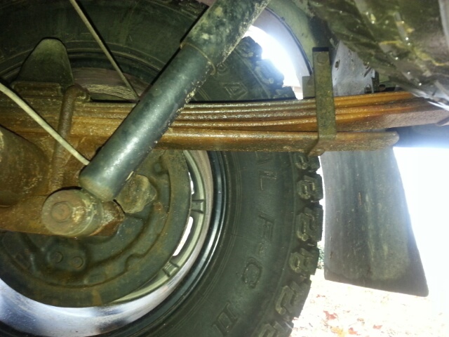

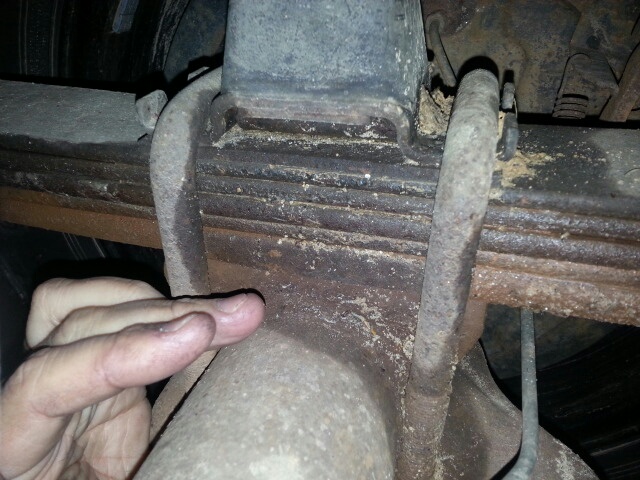

Ok.... So the zuk mod seems like the way to go with respect to sag for now. However, if and when I have to money to replace to Springs with something like ome, I will have to reweld the u shaped bump stop back onto the truck. Or as many threads I've read, I guess some people never move away from the zuk mod once they have it. Does the attached pic look like it's stock? I didn't know if the little block below my leafs was something one of the pro's added? The weld job doesn't exactly look factory.

Hers the front and back of the springs. The front is basically flat and the back has a little room fo flex. But I'm wondering if that little block is supposed to be between the leaf and the axle.
Sorry, pic not clear.

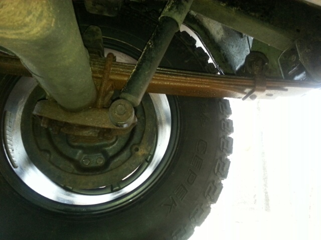

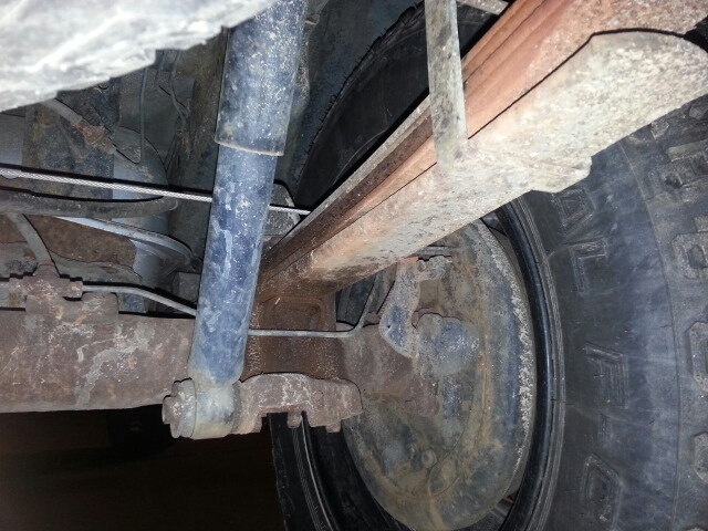

Here are some better shots of that welded block below my leafs. I'm still interested to know if that's stock.

Still.wondering if this is the stock suspension?
Yes, looks like stock to me.
That block is called the spring seat. See your FSM
