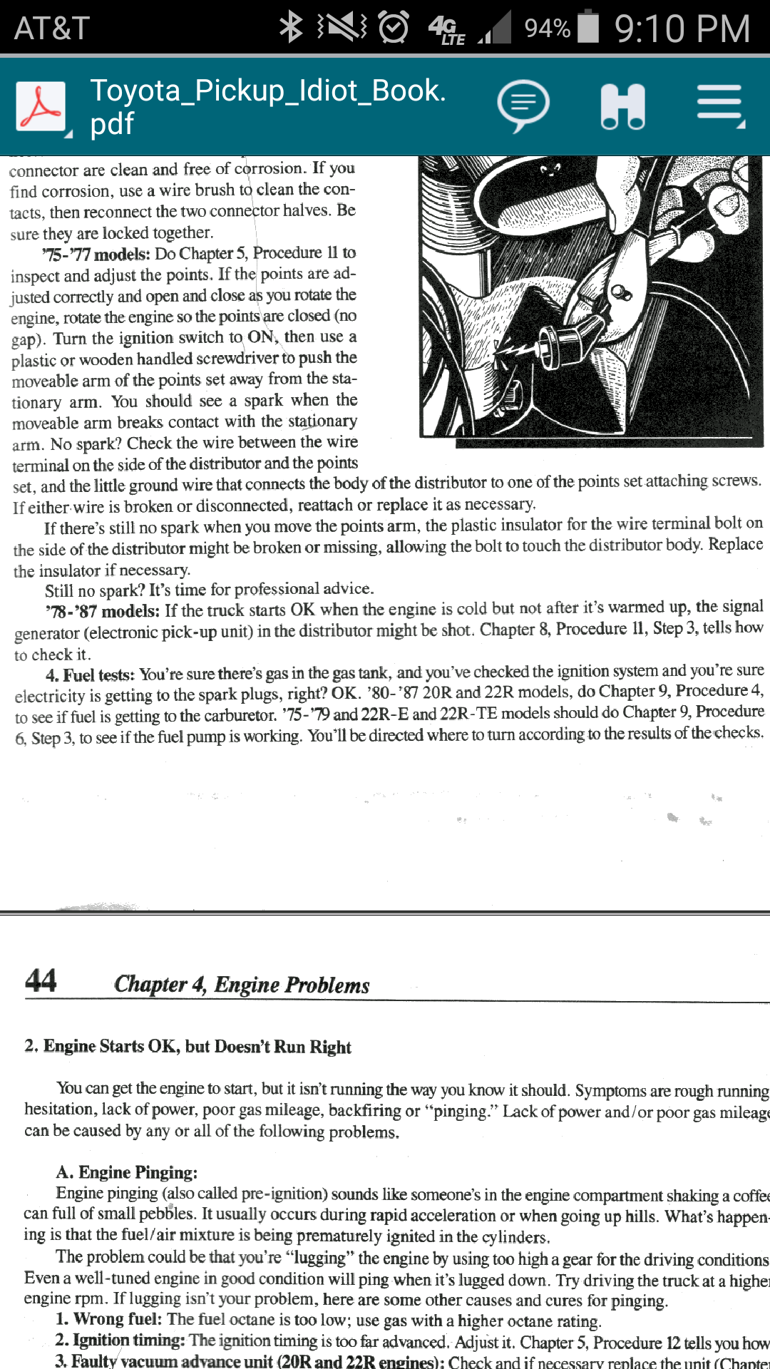

Found this in the Toyota pickup book
Electronic pick up in the distributor might be shot
Attached Thumbnails 87 22r hard to start when engine hot/warm-screenshot_2016-07-05-21-10-01.png
