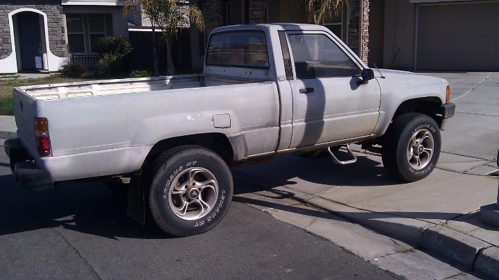

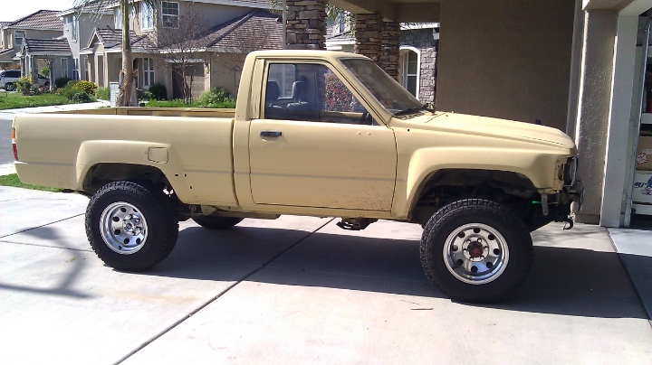

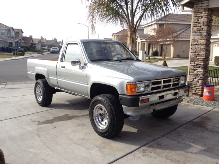

Here are some pics of my truck when I got her, and how she looks now.
Day One
After Tons of Body Work and Mechanical Work
Current
