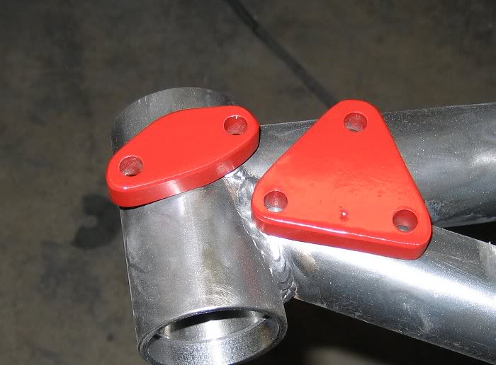

On the early 22re we don't have that EGR sensor so it's simplified a bit. Here are the two block off plates I made from 1/2" steel. Painted to look purty...well actually so they wouldn't rust.
Attachment 182149
Gasket and gooped and installed using factory hardware, pretty simple.

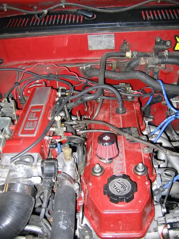

I removed all that stuff years ago and never had any issues. Here's a picture of how the engine looked with everything gone.
Attachment 182152

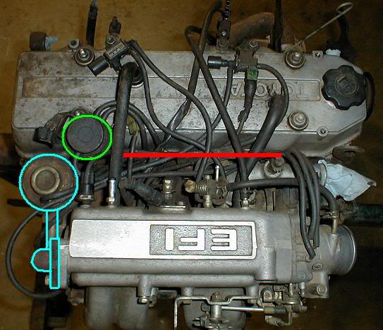

When removing the EGR stuff this is the basics to it. The blue item is the EGR. The red item is the formed steel vacuum line run. the green is the egr vacuum modulator. so basically almost every hose to these can get removed. You will need to make (2) block off plates for the egr, one for the head and one for the back of the plenum. or buy them from LCEngineering.

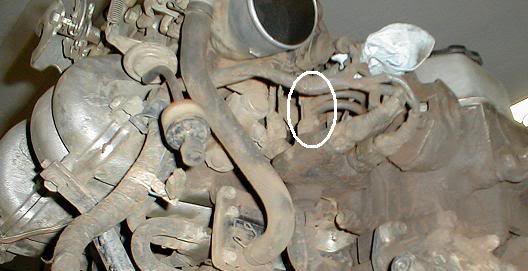

Then you can move the vacuum solenoid to the back of the plenum since there is no not egr back there and that helps clean off the top of the engine. Note, the wiring harness is long enough so you shouldn't have to cut into it.

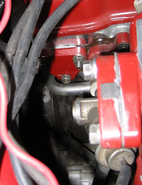

Attachment 182154
Then you can also remove the temperature sensor goody that controls the egr modulator and install a metric pipe plug.

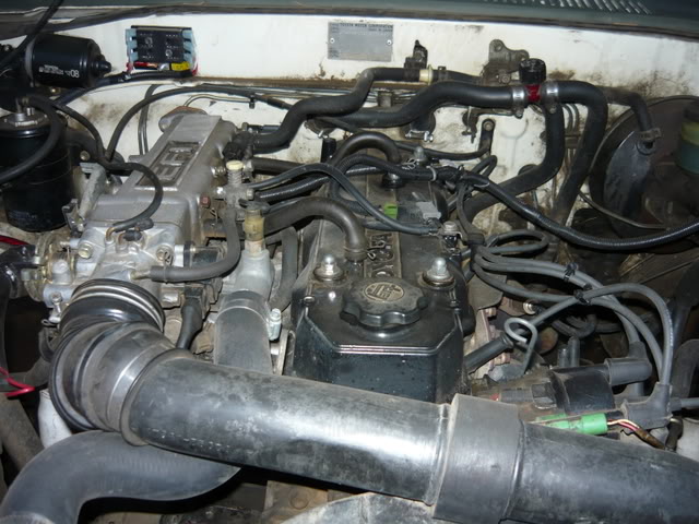

Forgot about this: This is the idle speed up valve (purple) for the AC and power steering. The blue lines run over to the Power steering. The yellow lines connect the vavle to the solenoid (green) for the the AC idle speed up button in the cab.
All of this can be removed if you don't want / see a need for the idle speed up. I could never get my didle to change when turning the steering wheel and I was seeting my idle high so to clean up the clutter I had removed all of this. but now I put it back on (except the blue lines) for a increasing my idle for rock crawling and I just unplug the ac clutch..
