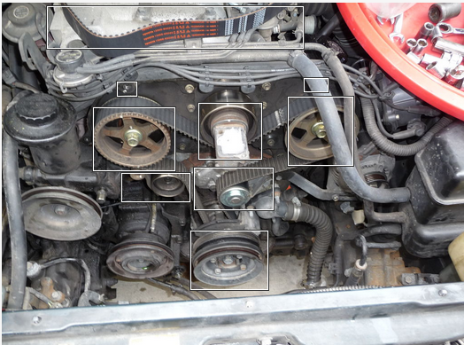

I have some coolant leaking out on the connection from the radiator to the water pump and it is making me nervous. i would like to open it up and replace the gasket but for the life of me i can not find a diagram with the part number.
here is the location (dead center where the white coolant is, this isnt my vehicle though)

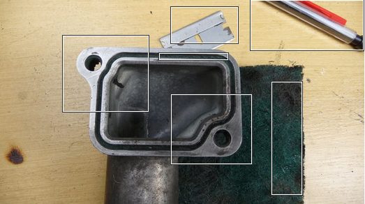

and a shot of the other side of the hose

Use silicone sealant in the groove....

so you're going to take the water pump off to replace the gasket? Make sure you inspect it for damage!
Go to toyotaoverstock.com it's relatively easy to find what you are looking for there from the diagrams.

There is no gasket there. Silicone is good, but I use RTV "for water connections."

I'm not removing the pump, just the connection where the hose exits and heads to the radiatior.
It's leaking a little bit
