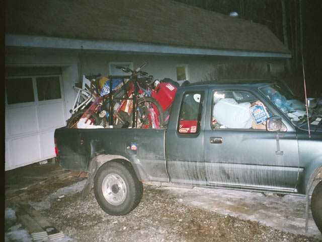

cool, thanks, now i'll just take my haynes manual off the coffee table and see if i can find a trouble code list. if not in there, like you said, look online. now my friends work at a toyota dealership so i should be able to fanagle them into getting me parts at cost (i sold cars there for about 2 months last spring, how i met them, and one of them whose motorcycle i'm fixing just bought the same vintage 4runner for $3000 so he can buy it ignitor if that is the problem and claim it's for himself.
oh yeah, what's y'alls opinion on aftermarket ignition systems? i have yet to research prices, but just wondered what you thought of them.
thanks a lot for the help, think i was here 2 years ago when i did my timing belt, water pump, and cam seals in my garage after making an epic 2 week cross country journey back to mammoth that included riding the tail of the dragon in NC/TN, skiing a week for free @ copper in CO (stayed w/ my old boss for free in frisco, yee haw, brought him and his roommate a case of yuengling and made immediate friends w/ his roommate, esp since u can't get yuengling west of the Mississippi as far as i've seen. Then i skied for 1/2 price in aspen highlands and fanagled a free lift ticket from their ski school (i taught kids ski school in mammoth for 3 seasons) and rode snowmass on a blue bird day w/ a foot of fresh pow, and the most recockulous part of the trip, made it from the parking lot in aspen to a friend's couch in so cal in the desert by about 4am the next morning. MAN, i was beat, skiing all day hard and driving all night, knew i couldn't make the extra 3 hrs to go straight to mammoth, so i went south somewheres in Nevada after i called him and said he'd be getting up around the time i got there to go 2 work. 3600 miles total. and YES...I overpacked, check out my truck the night I left Blacksburg Va for Deals Gap, TN. had to fight to keep my leathers and other stuff out of my lap whilst going through kansas!
Attached Thumbnails 3vze won't start when hot, now won't start at all w/o starter fluid?-websized640x480-team-beverl.jpg
