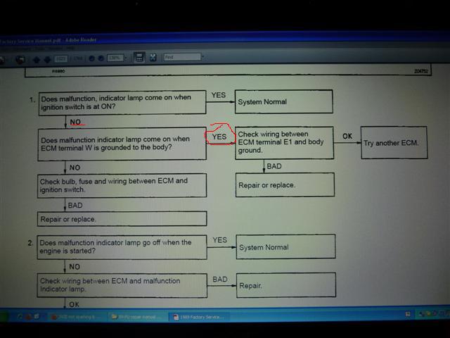

Hi Tim,
Sorry it took a while to get this PM but I've been away from the computer. The FSM has you test for proper ground at the ECU next. In the ECU diagram picture the red arrow points to the E1 terminal, which is one of the grounds. The wire is the 4th in from the left on the lower row and is brown without a stripe. The blue arrow points to the violet wire you tested to see if the "W" circuit (check engine light) works.
Check for ground continuity at the E1 terminal (connector plugged in, key off) with a known good body ground near the ECU.
No continuity: bad ground wiring or connection
Good continuity: bad ECU
It's a bummer but unless the ground has a problem, it's looking like an ECU has failed.
The MFI or FI section of the FSM has a complete troubleshooting section for the ECU. If you go through that you'll find out if the ECU has problems beyond the check engine light.
Take care,
Bugs
