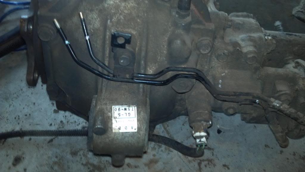

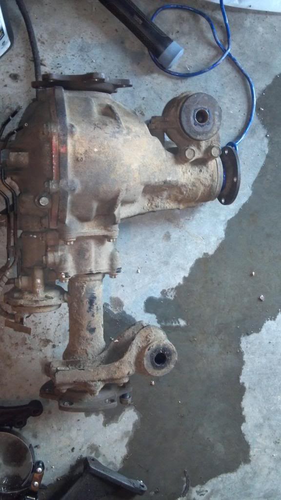

Some pics of the diff out.

[QUOTE=FlamingToast;52078622]Some pics of the diff out.
Flaming Toast. These are perfect! This is so much easier then trying to just some written instructions.
