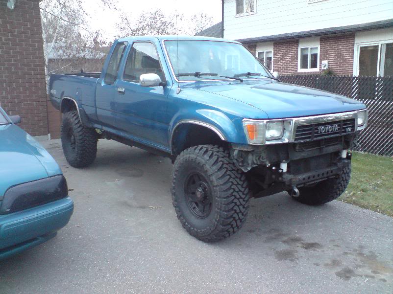

here is my 91 on 33x12.5s
and they dont rub when wheeling either. or at least i havent got them to lol

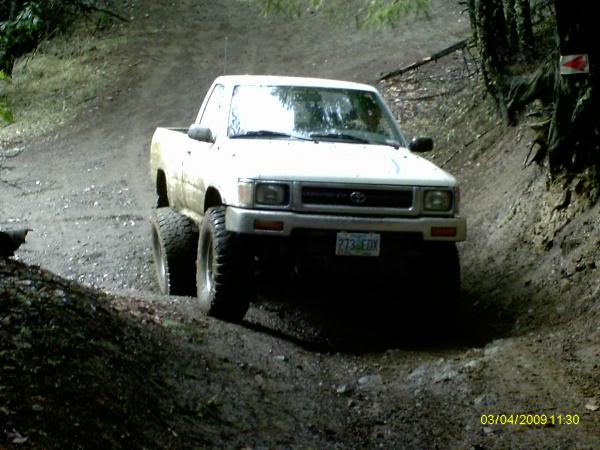

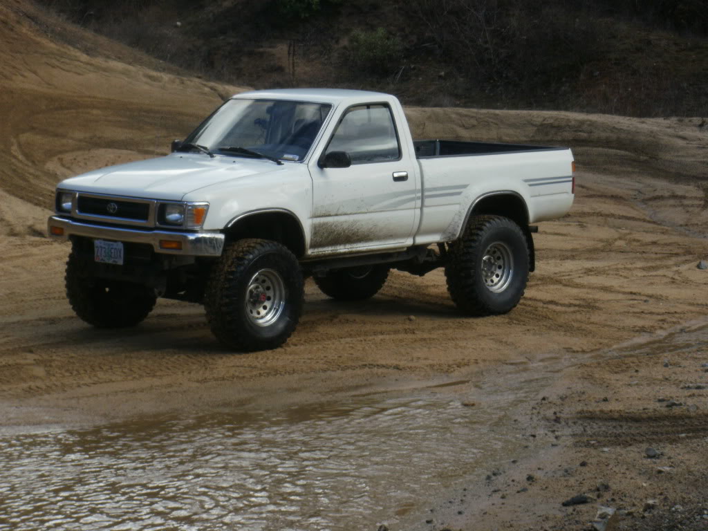

Originally Posted by BoredOutnJackdUp
seriously go for it!
I only have a 2 inch body and could run 35 or proabably 37s.
i just had to cut the plastic fender liner by the pinch weld a little.
diggin ur 91

Originally Posted by yotarover
diggin ur 91
Thanks man, she's a work in progress haha

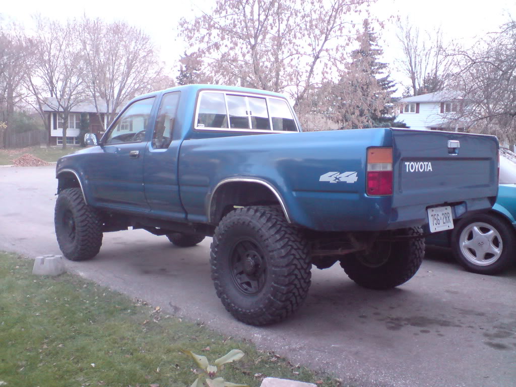

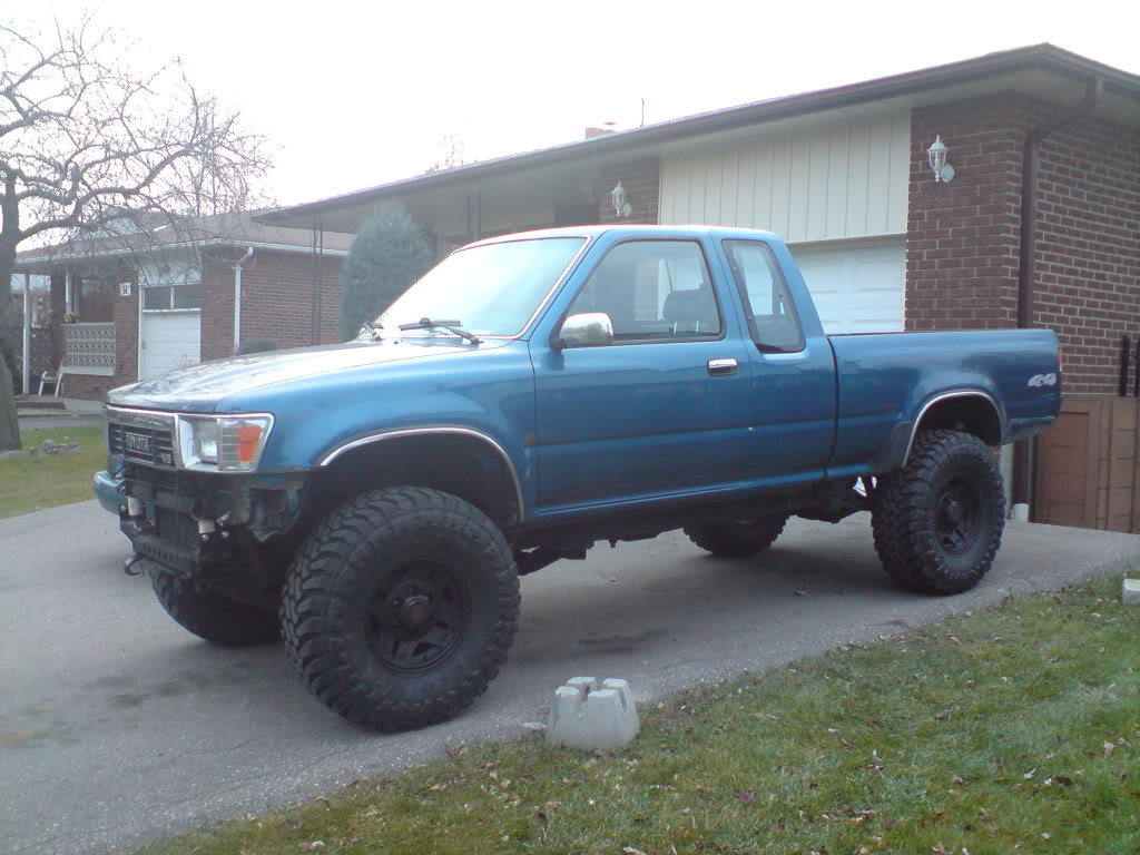

My bud has 33x12.5's on stock sr5 wheels on his 90' pickup with just a 3" BL.
No rubbing...
