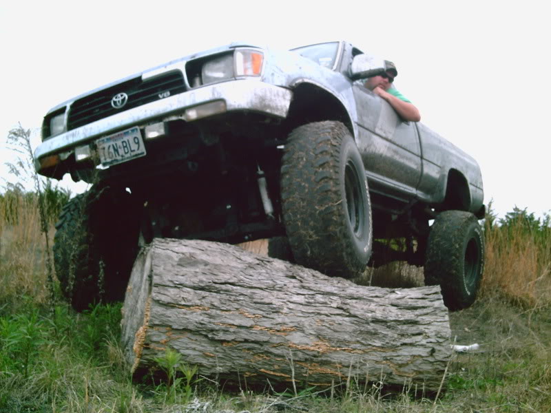

i'm pushin' 35's w/4:88's, and i've got my final drive as close to stock as your gonna get...
sucks havin' to put it in 4th goin' up big long hills, but it's tons of fun in town....
thinkin' about goin' down to 33's....
