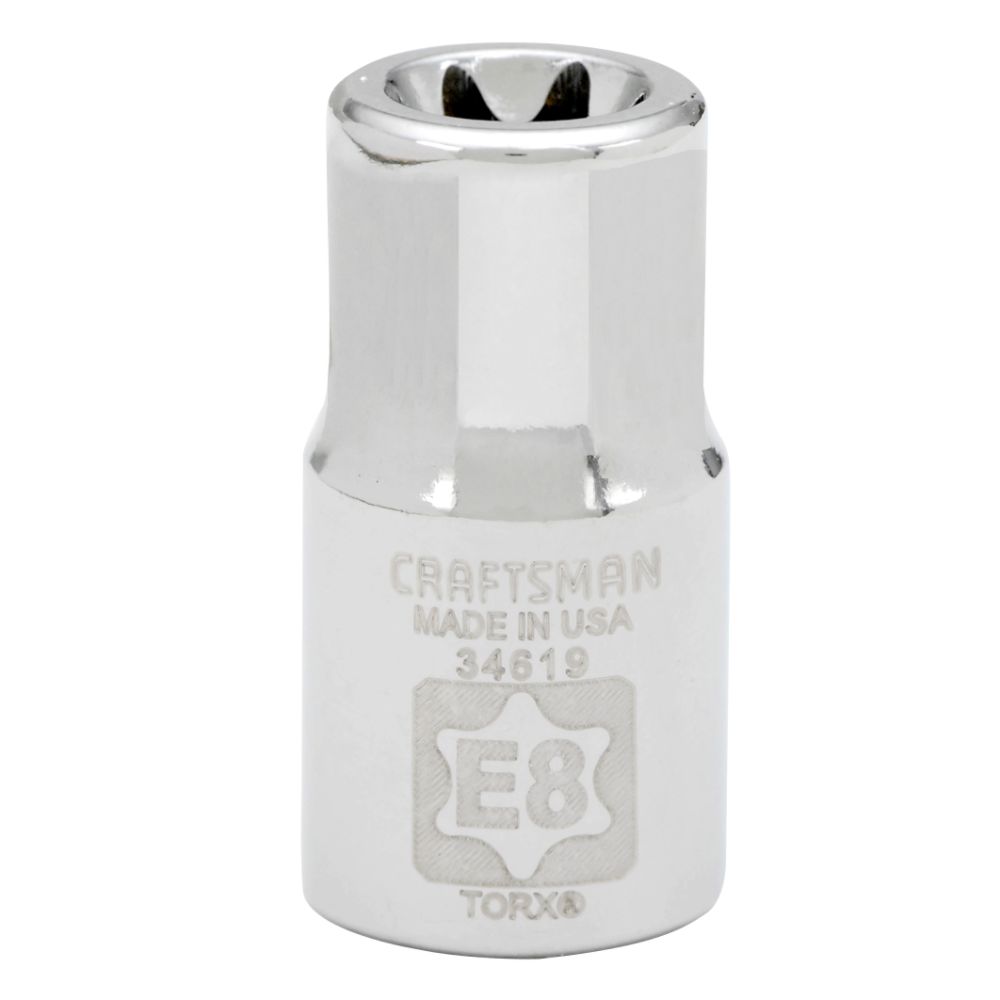

Simply remove the 12 exhaust manifold nuts, then, purchase an E8 female torx socket.
Remove the 12 studs. Then remove the heads. It is unbelievably easier than getting the x-over off. The x-over pipe causes the manifolds to spread out just a bit, giving you plenty of room to move the heads around when putting them back on.
Here is the craftsman one I have.
