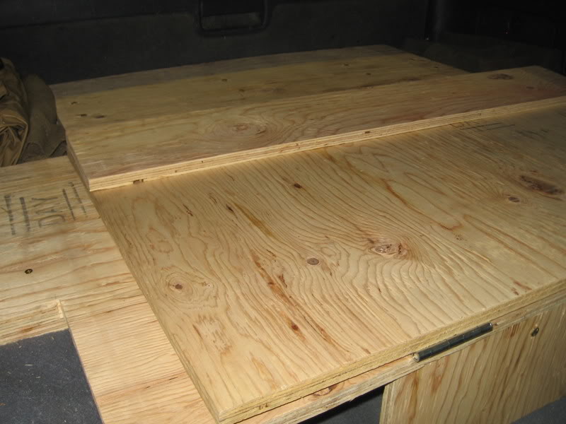

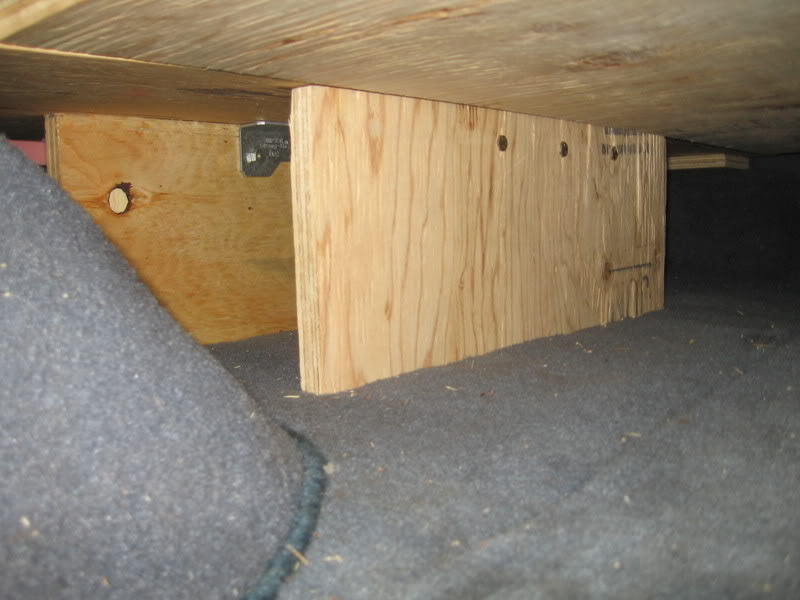

Well I've been toying with the idea for a while and today my dad picked up a couple sheets of 4x8 plywood and some hinges. My idea was two slots for plastic cargo boxes and a cubby with a tackle box style trays. that didnt end up working out unfortunatly, that would have been pretty cool.

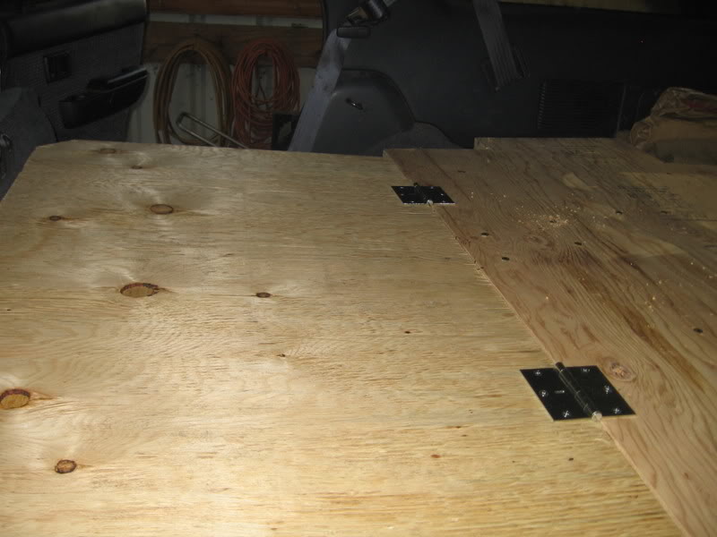

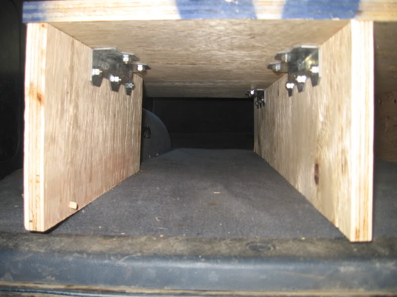

Instead I have two slots that go to about 8 inches back from the back of the seats and one that goes full length to the seats with no dividers on the ends for skis or shot guns . then betwee the two shorter slots and the seats a small hidey hole for handguns maybe . Then for when seats are down which is almost all the time there is a large sheet that folds over to cover the seat backs when they are down. Where the little cargo things in the back of the 4runner are, right behind the wheel well there is no ply wood so i can get to the holders.

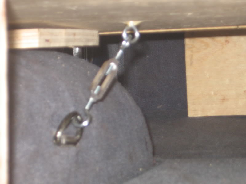

To hold this whole thing down I used small turnbuckles conected to the factory tie down loops on wheel wells and back corners. There are no measurements and plans sorry, this was a build as we go project. its not quite done, I have to buy some bed liner material to cover the wood with still.
the rear part without the folding part made yet
the corner cargo holder and passenger wheelwell

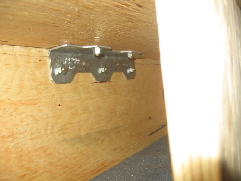

the brackets we used
the folding part in seat up mode

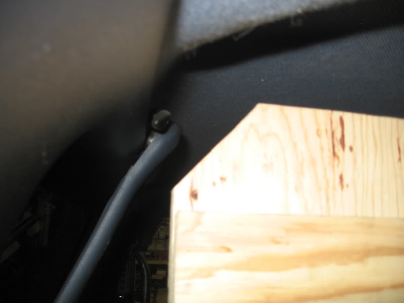

seat belt bracket clearance
the "hidey hole"
turnbuckle fastener
this slot holds two cargo boxes
the shot gun area
the suport for the seat platform
seat platfom folded down
the tailgate latch clearance

use T nuts
That will give you more room for the bolted brackets that you are using.
Or use a biscuit jointer and biscuits to glue up the sides (hidden fasteners)

The brackets we used accually work great and are low profile.
This project cost about 50 dollars and took about 8 hours of work. my dad accualy bought 2 sheets of 4x8 ply and we used most of one. we have about 2 square feet left.
