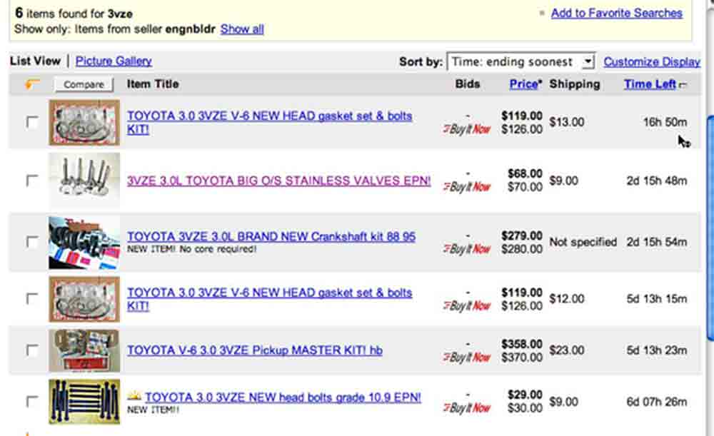

Here are the parts that engnbldr sells for the 3vze on ebay:
which ones do you recommend, and if you know any other 3vze aftermarket engine rebuild/HG parts, I would love to hear about them.
thanks a lot- if I have the HG done, I really want to make sure that I have all the other recommended engine mods done at the same time.
needed replacement crankshaft? or, valves?
do you recommend the master kit, or just the HG kit?
thanks a lot

I dont know if the master rebuild kit includes the headbolts, but be sure to get those.
Swapping cams in these engines are cake since there are no bearing inserts, so do weasy2k's cams! DEF worth it.
Engine builder also offers oversized intake and exhaust valves, which honestly these heads NEED bigger valves particularly on the exhaust side of things.
Perhaps even headers if you have money buring a hole in your pocket!

master rebuild kit does include head bolts!
weasey2k's cams, how to get them, how $?
so- master rebuild kit, cams, and valves, and that should do it for the 3vze?

does the master engine rebuild kit include everything that I need for the full headgasket replace and repair, including bolts?
ie. if I buy this, does it include all parts for everything?
also...do you consider this a good deal?

Master engine rebuild includes everything you need for a HG replacement pluss MUCH MUCH MUCH more.
It includes everything you need for a complete rebuild of the block.
I just went with rings, bearings, full gasket kit, and head bolts. i reused pistions, oil pump, freeze plugs etc. and saved some $$
and yes very good deal!
master rebuild kit
thanks snap-on, bumpin, ganold, dirtcheap and elton
looks to me that the master rebuild kit is the best option for the 3vze.
