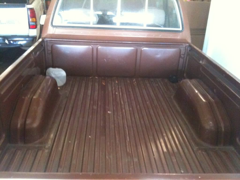

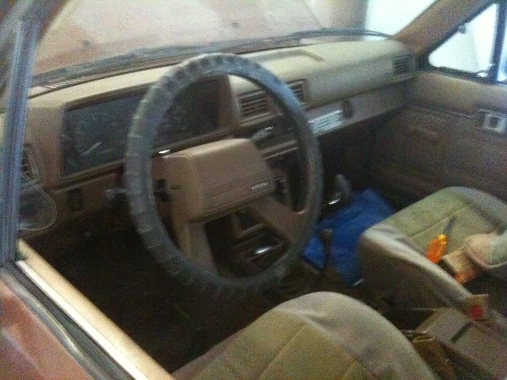

As much as I wish this was my truck its a friends :/ but anyway, its an 1987 toyota 4x4 5 speed 22re single cab with 187k miles. and i noticed it was leaking water around the water pump. I offered to clean it up, swap it out, and do an oil change on it. but its starting to be a bit more complicated than that.
Here's the truck for some eye candy
