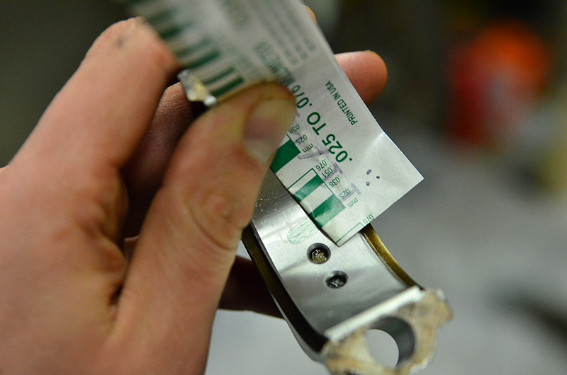

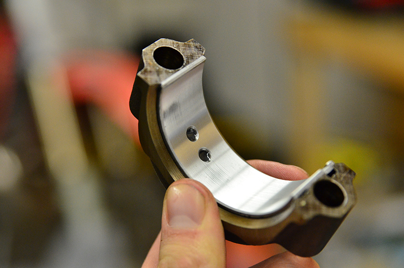

Heres a picture of the scoring and a plastiguage reading.

You're good...same as me, paranoid....still running like a champ!

Thanks for the reply Greg, Good to know. Im still a little worried since my clearances are tighter than yours and because I can not turn my crank with a 1/2 inch wrench. were all your rod clearances at .038?

Yes, they were all about the same.
Not too long ago (months) I worked on 5vz rebuild. Clearances were well within spec but the crank turned WAY easier than mine. The only difference between the builds was the 5vz cylinders were coated with some motor oil and put the recommended amount in the ring areas. On the 22re I used WD40 on the cylinders and the ring areas. On both engines the cylinders were only honed and new NPR piston rings (standard size)
So I guess my question is did you put some lubricant on the cylinder walls and the piston ring area per the factory manual?

Yes the cylinder was lightly coated in engine oil as specified in the fsm. Im thinking that the problem may be that I used assembly lube between the rod and bearing. Maybe this effected cleances?

Yes, I believe the fsm says to measure clearances when dry.
I think that is why some tend to skip the plastigage step, it's "extra" work to them rather than a "necessary" step. You have to do a complete install dry, then take it all apart, lube it up and install again. If you ever visit Japan and/or have relatives or friends who work over there, you'll come to understand why the stuff they produce is usually right the first time when it comes to market. They take so much pride in their work no matter the job, whether a janitor or doctor, they rather check twice and do it once to help prevent the shame of a failure.

those rod bearing pics look like there was grit in between the bearings and the rod mains, is the crank scored in any way?... btw, did you remove the allen wrench plugs in the crank, and blow out the crank journals with carb cleaner and compressed air? and/or brush them out with pipe cleaners?

@Vital22re Yes I put assembly lube under the bearings I now realize this is wrong and cleaned all the grease from under bearings.

6 the crank was just resurfaced all bearings were meticulously cleaned before assembly/No I did not I would hope that this was done at the machine shop but is there a write up for this or do you know hoew tight to retorque the allen plugs?
7 The pistons are brand new ring gap was measured and all were within spec.

if the crank mains/rod bearing areas were turned or even just polished, there could be residue still left over inside the oil passageways, leading to the bearing surfaces... you can see the potential for a problem there, I think, but most people don't bother with it.
you could ask the machine shop if they pulled the allen plugs, and flushed those areas out, but I doubt that they did... typically you run the allen screws down fairly hard, it's steel against steel, using a good grade of locktite, something that will stand up to heat... it sounds like a potential disaster, lol, but the locktite keeps 'em from coming loose, and the threads actually deform under the torque... I would not overtorque 'em, if that is what you are asking, just a pretty tight snug.
