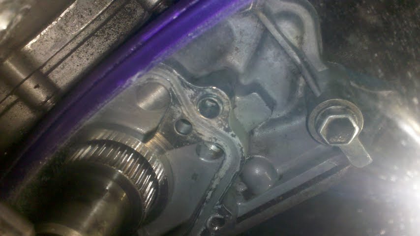

Digging this one up..... I searched because I have the same EXACT problem. Did you figure out what's going on?? I made it stop a little while by putting a ton of ultra grey on the bolt and shoving it in leak is back though... and that's just ghetto
So I did about the same thing to try to solve it. After further investigation and some naughty words I think I have figured out the issue. EBay parts... that's it. I bought a timing chain cover from eBay and its like an aluminum piece of Swiss cheese. The "hidden bolt" in the head has obvious porosity visible in the threads. BUT, as far as leaking around the oil pump bolt (the long one) I found more porosity within the t-chain cover. One hole and another big hole. With a mirror and flashlight I found them and with a curved dental pick I verified the holes. I assume since they are around some major looking oil passages that oil is being pushed in there. I will confirm once I get a blow gun with a rubber tip. This aluminum has bubbles in the casting everywhere! dun teached me a lesson on buying cheapo crap parts.
More to come... After I find a blow gun.

Thanks, I have explored all options you mentioned. The hole in the timing chain cover that said bolt goes through has some porosity or bubbles in the casting. I'm assuming the holes go far enough to let oil in around the bolt between the threads and the head of the bolt. Do you see what I'm saying?

I have replace the gaskets twice, sealed the bold with sealer, explored about every option. I'm thinking this is the problem and that a quality timing chain cover will solve the problem. I would like to know if 352ford found the problem and if not maybe its the same deal.

The best pic I could get while holding a flashlight mirror and camera... Looks like a chunk missing inside the hole there is another hole further back
