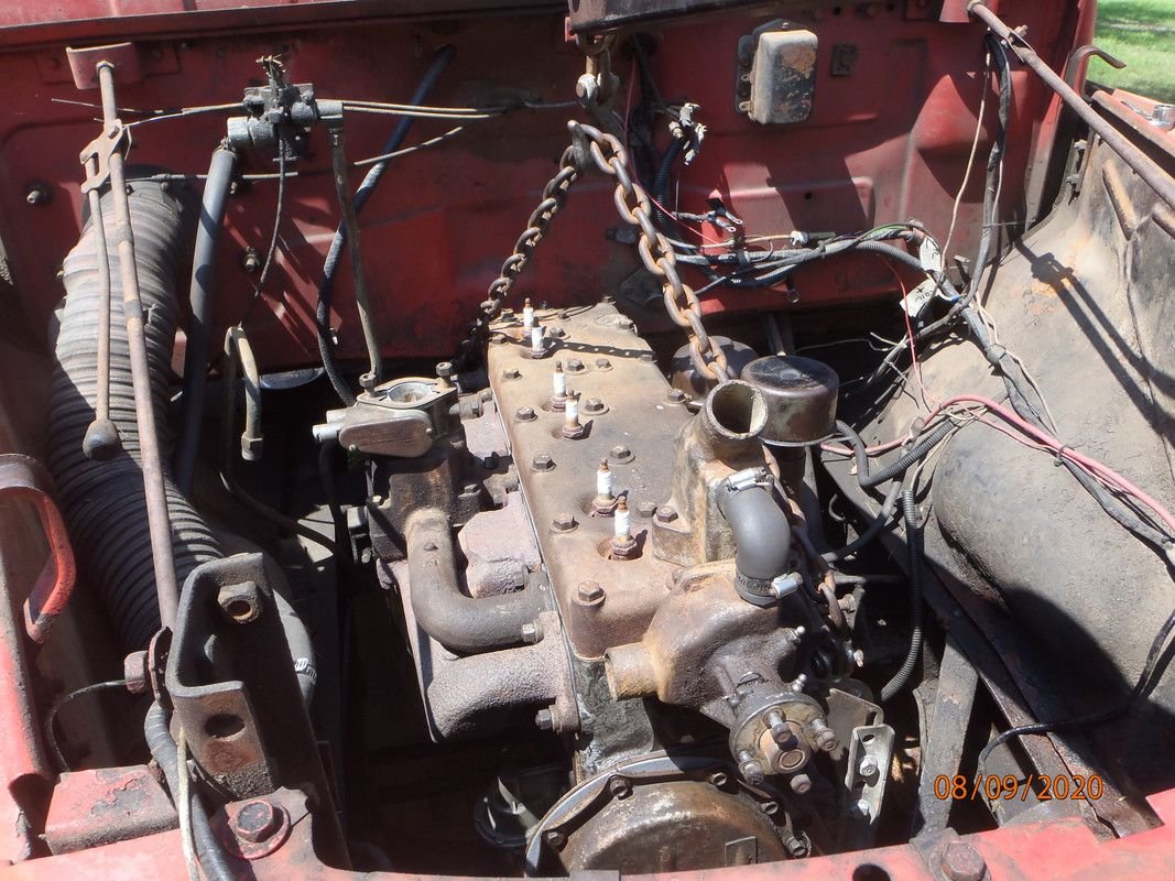

the first time i used my transmission jack, along with the hoist, was to install the flathead 6 back into my dump truck. i did it out in my yard. it was the easiest engine install i've ever done. i lowered the engine into the bay, pushed the hoist forward, and the transmission input merged perfectly with the clutch/flywheel. obvious a bit of luck having everthing in perfect alignment at the initial setup, but it shows that when the alignment is correct, very minimal effort is required to get them together.
