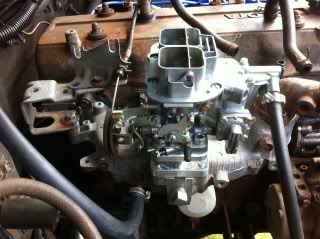

I love Efi but have bad running issues with this truck.
I removed all Efi intake,computor,distributor and ignitor coil.
It was easy to do I kept the Efi gas tank and Only disconnected the Efi fuel
Pump wire and installed A low pressure pump,I used the LCE water block kit
On the intake,head,timing cover,LCE egr block kit,LCE carb adapter
A weber 32/36 puerto rican modified carb(swapped venturis).
The ignition was simple just using the carb distributor/ignitor coil bow and wiring the white wire to the Switch(+),I also plugged every port except the brake booster On the intake side,I also used the Efi plenum throttle holder and throttle bore linkage on the weber.see photo below
The truck starts up fine no leaks or rough idling and timing set at 12degrees
Took it down the road and so far none of that hard to solve

Looks goo but.... I need to learn something new, please explain "A weber 32/36 puerto rican modified carb(swapped venturis)."
And is that a manual choke I see and not an electric choke?

I got this one on ebay and it doesnt have the stock venturis in it on both barrels
