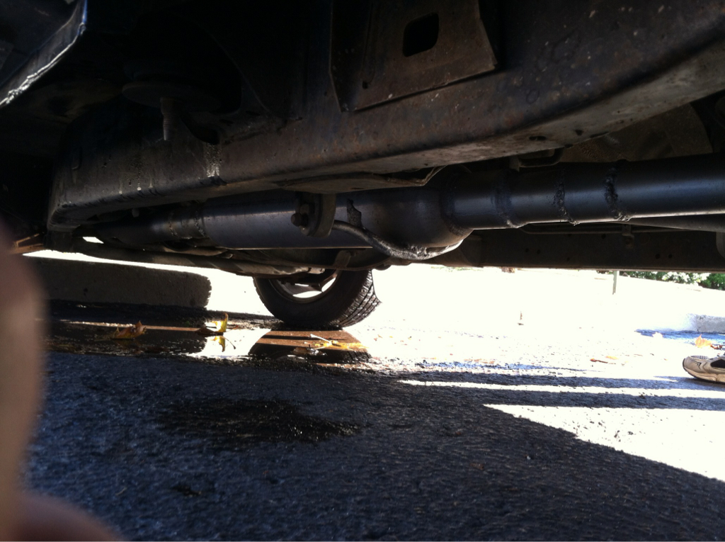

Here is my stock size exhaust system I put on mine I believe my stock size was 1 3/4 it only cost me 34 bucks 10 for new use muffler at junk yard 18 for new tailpipe at orilley auto and 6 bucks for a 2 foot piece of 1 3/4 pipe. Of course I prob saved 50 bucks welding it myself but it could have all been clamped together
Nice! How do you like it compared to what you used to have? (is it installed yet?)
And what did you have before you made that?
