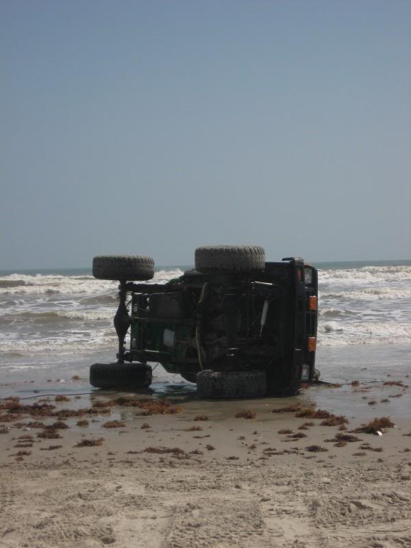

Well I did finally do something about the exhaust. Picked up one of those cheap thrush mufflers and welded it on. Can kind of see it in this pics (sorry, never took a pic directly of the exhaust):
It didn't completely solve the "backfire" (w/e abe... Lol), but it certainly helped reduce the frequency and intensity. Plus it was only $20 at autozone, so I couldn't complain.
