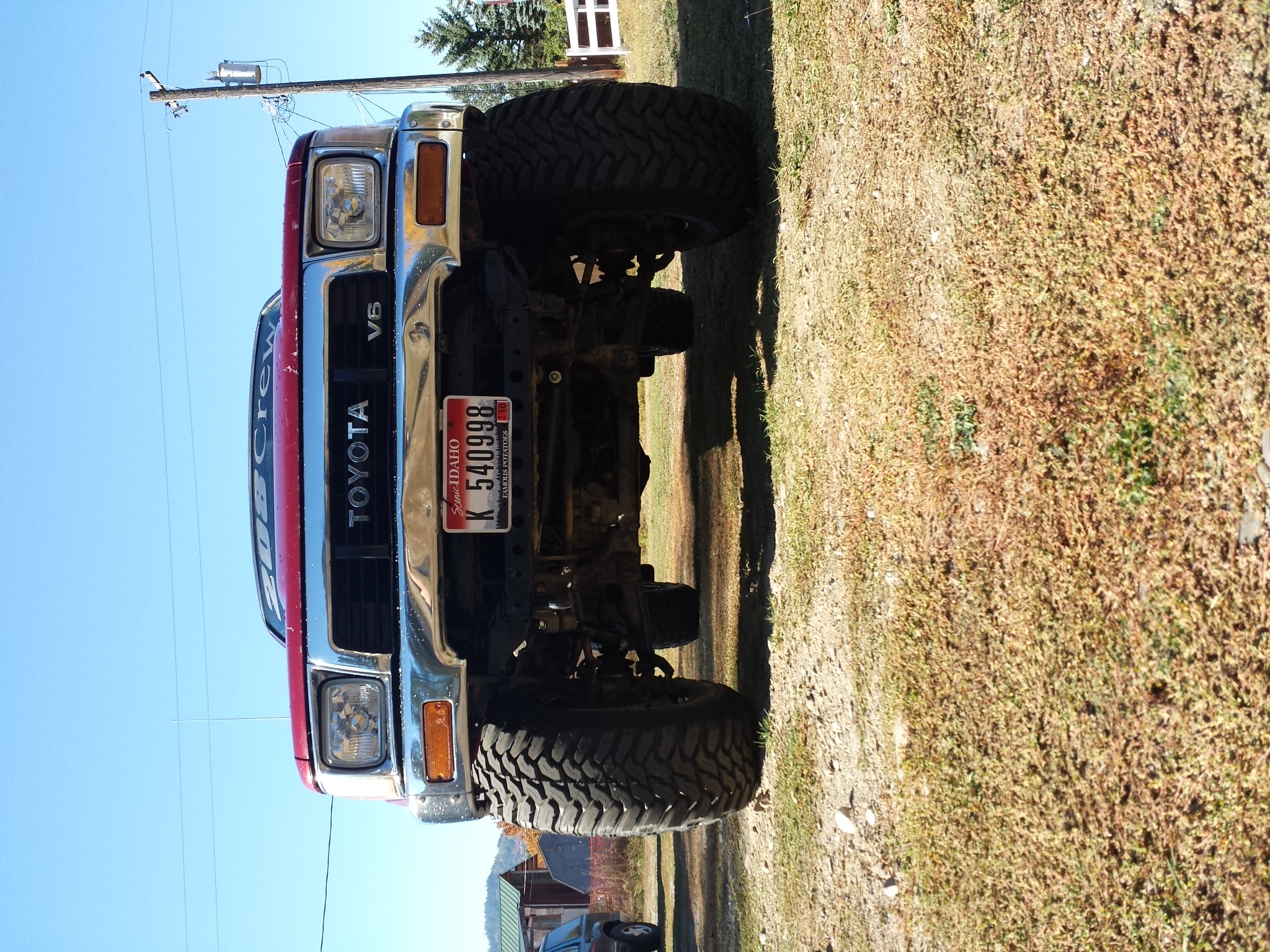

With the new wheels and tires
Attached Thumbnails 2" lift w/o using body lift? 1991 ext cab-img_20141010_124555.jpg   2" lift w/o using body lift? 1991 ext cab-1412815567214.jpg

Idk why the one pic is sideways...sorry lol
