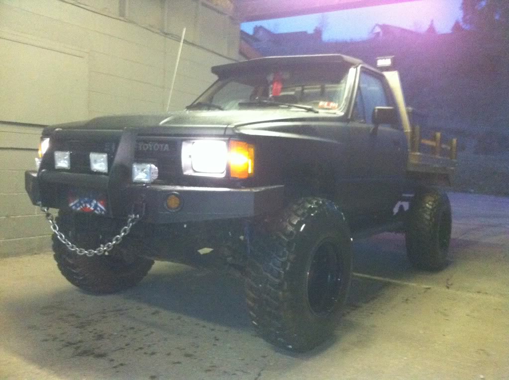

I bought #2 about 3 times now. Yeah that's right I said 3 times lol. I bought it for my 87 pickup, 93 pickup, and my 95 t100.
I ran 33" tires on the 87 and 93. The shocks are pretty good shocks. Rest the hardware is good quality too.

34/10.50r15 tires in this pic

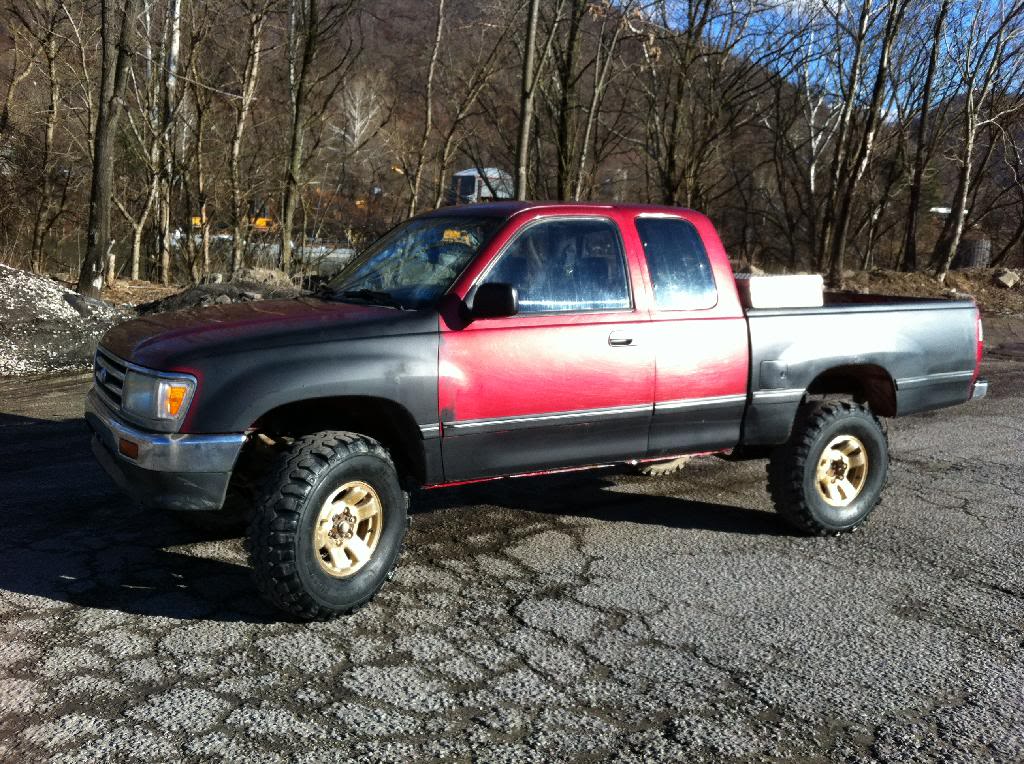

Here is the ride height of my 93 with about 2" lift:
1.5" BJ spacers, OME Dakar medium leafs, OME shocks, stock shackles, stock t-bars with slight crank. Measures 22.5" from center of F/R axles to bottom of fender lips. Tires are 33x12.5x15 Toyo's on 15x8-3.75" wheels.
Lift is JUST enough to clear the tires with some minor sheet metal modification in front (pinch weld area and bumper/valence).
