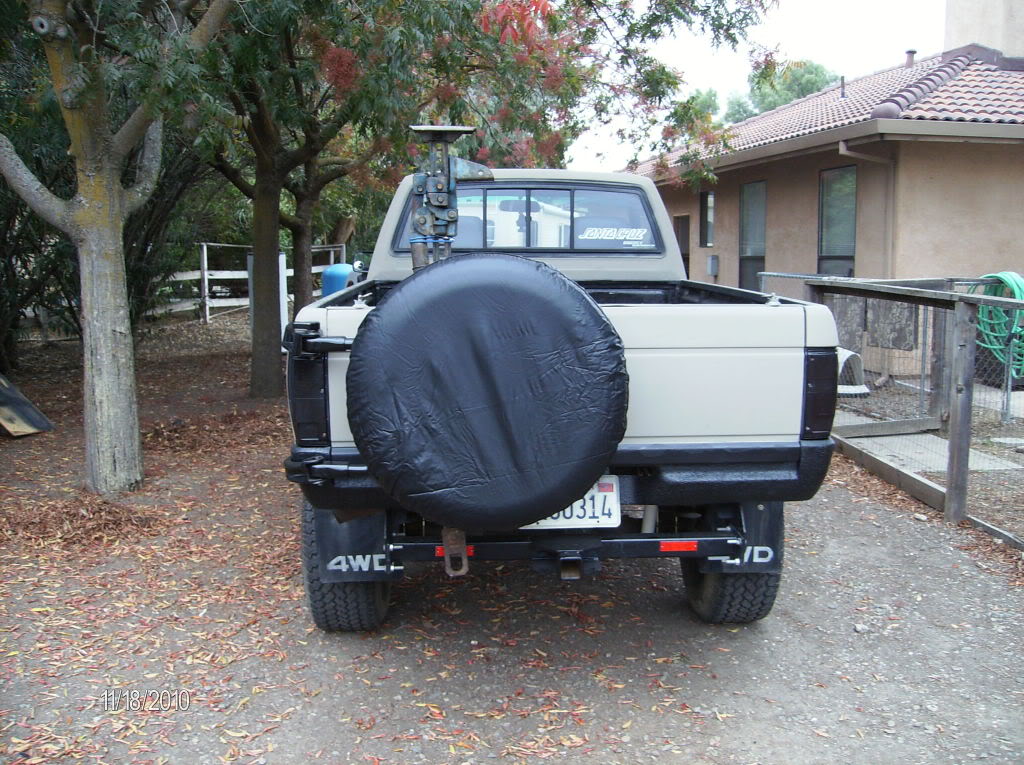

Agree on the loss of visibility.....I have a cool idea/concept that I have never heard or ever seen anyone use and I'm not sure why...it's really simple and cheap..I'm doing it for my set-up...and that is to remove the valve stem from the tailgate spare and put it in the glove box. With no air in the tire now the tire moves independent of the shaking wheel over rough terrain. This has the effect of reducing bending stresses on the carrier probably by about 50%. And, if you go thru a ditch and the tire does catch then it won't tear the hell out of the mount set-up....the tire sidewalls will give way, bend and fold up to 180degrees and the carrier/swing-out assembly likely won't suffer any bending.....unless it's a really bad ditch.
This means a tire pump is also to be carried....something every offroad rig should have anyways.
Here's a shot of my humble re-located mount.
