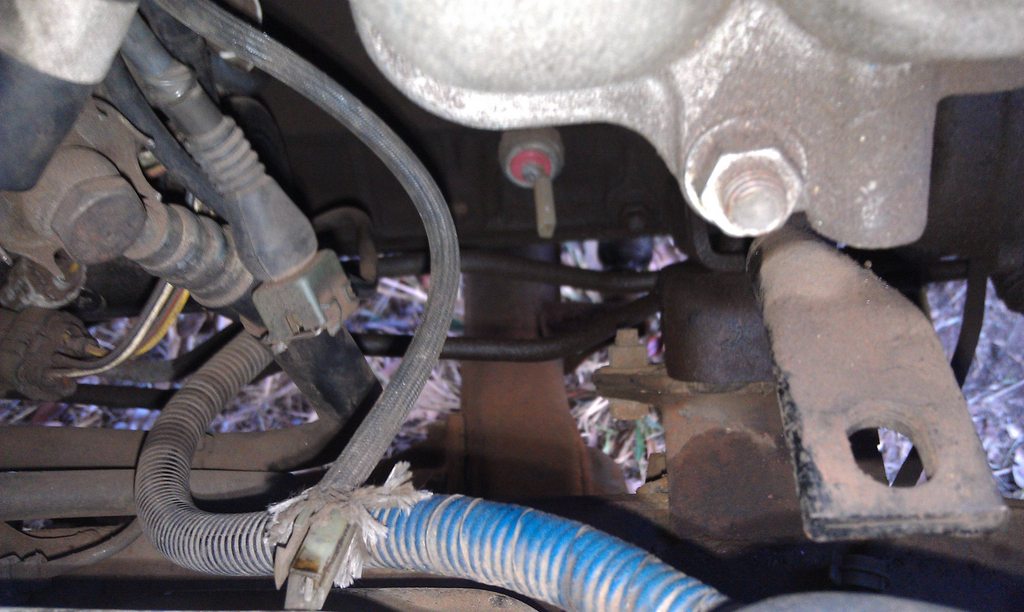

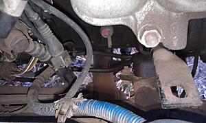

So went out side to tinker for minute and this is what I came up with.

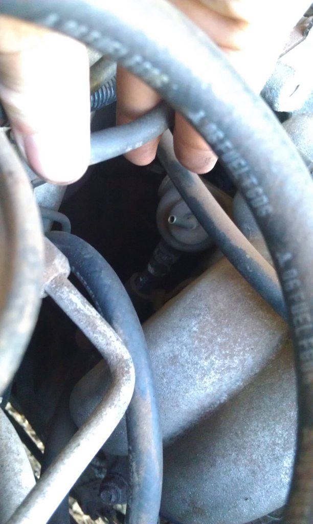

This is the dampener/ regulator? I notice the idle go up and smoooth out a bit when I pulled hose. I have a question about this a little later.
Now these guys.... 3 plugs, The one in the middle left kind of has a plug that reminds me of an injector but not white? not sure what the one with the briaded loom does and hove no clue where the (knock sensor?) wire is.

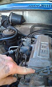

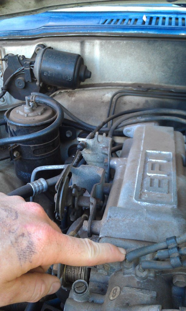

The small vacuum hose on the cainister is going here on the throttle body. I pulled all the lines and felt no vacuum any where.

On your 2nd picture, I think it is called a regulator, that is how I check to see if it is getting good fuel flow and it eventually goes back to the tank. If I recall right, the line goes to the inner fender on passenger side. That is where I had the (in my first picture above) gear fluid bottle cap to use as a funnel and poured Marvel Mystry Oil in mine to break up the rust.
Another way I check to see if it getting guel flow to the rail is to loosen the Cold Start Injector feed line and it will spray fuel out fast. Just thought I would add that for info.
On your 3rd picture, the red sensor, that is your Oil Sender Unit. It has a broken wire on it. For some reason, Toyota made another little wire about 4 inches long that connects to the wire that is laying on your blue wire harness. Grab one out of a boneyard and you will be able to hook up your Oil Sending unit again.
I cant see your Knock Sensor, but it is a white plug near your fuel filter.
I cant recall what the green connector goes to right off. Might be to your IACV Valve, located just up above the AC compressor area.
Also on your 3rd picture, it easily forgotten, that black/dusty rod is to be bolted to the bottom of the Plenum, it is there for support.
On your 4th picture, I would double check and make sure all of your vacuum lines are hooked up correctly. Not sure where a good diagram is at. I have three 22res and always make sure I have one for a reference. Vacuum may not be present on all of them and the hose connections coming off of the Plenum can be plugged with carbon caused by the EGR.
I have run into this several times which isnt related to your fuel pressure but could make you think you dont have vacuum.
