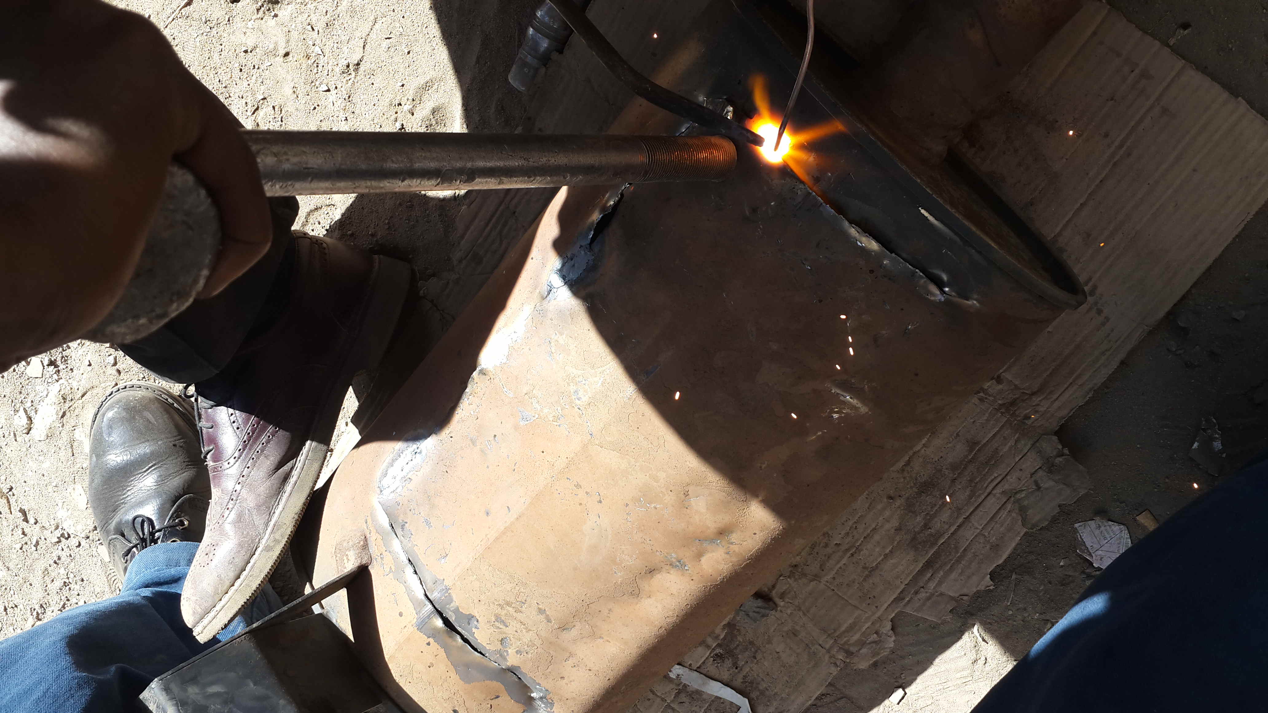

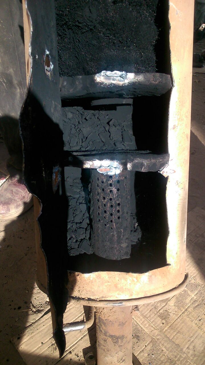

Hey,
That looks like a clogged silencer too...The spurts of smoke come from pressure building. .kenya style we remove the silencer and cut open the top scrape and pour the soot then pressure wash. Bang back the top and gas weld it. Works wonders on performance and consumption.
some silencers built without blow by.
running the engine after reinstall will dry out the silencer.
Attached Thumbnails 1KZTE black smoke, excessive fuel consumption-img-20150318-wa0032.jpeg   1KZTE black smoke, excessive fuel consumption-img-20150318-wa0034.jpeg

Old 04-06-2015, 11:28 AM
six2's Avatar
Join Date: Sep 2013
Posts: 2
Received 0 Likes on 0 Posts
Soot pic before pressure wash
Attached Thumbnails 1KZTE black smoke, excessive fuel consumption-img-20150318-wa0052.jpg
