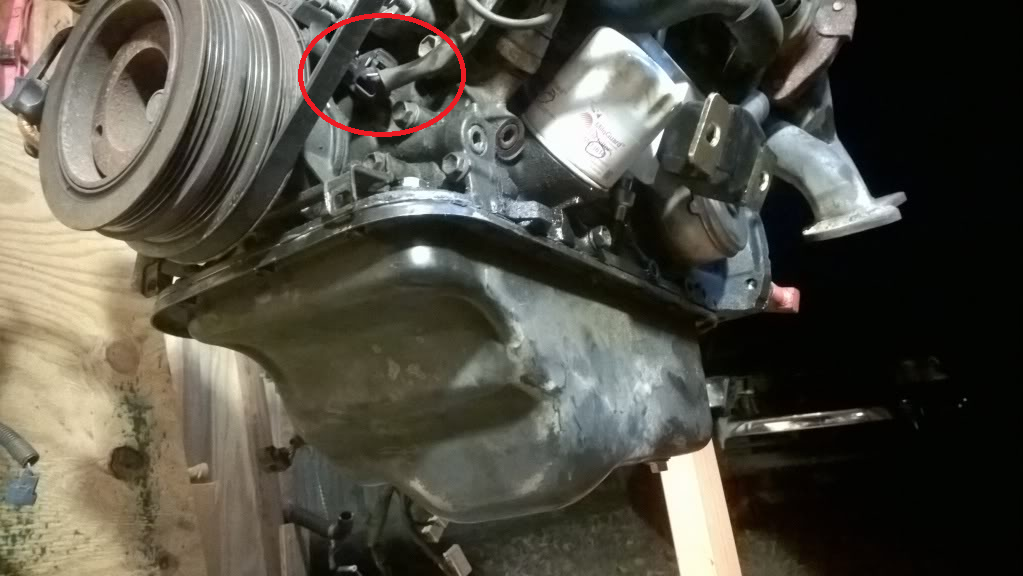

From when I did my engine swap. It might be easiest to get to from the driver's side wheel-well.

Wow I will save this picture and text it to him. Is this the same engine as 3.4l 1995 toyota tacoma? Do you have another picture that shows another angle for the other end. This one looks like the electrical end piece. Didnt know that electrical end was that close behind the crankshaft pulley...thanks!

Here is an update. I was able to finally locate this part. Unfortunately the part I ordered was for the wrong engine. There is this grease that has been leaking out, and it hid the sensor well. Also that grease was smeared all over the wiring. If you look at the pic you showed me, its around the adapter and the end area of the wiring, and especially hiding the end that gets bolted in! I need suggestions. Should I just clean the part, or replace it? Also, I heard about the crankshaft grease that needs to be refilled somehow. Not sure about how to do that. Something is definitely leaking and it might be the seal for the crankshaft. Need help here, and thanks!
