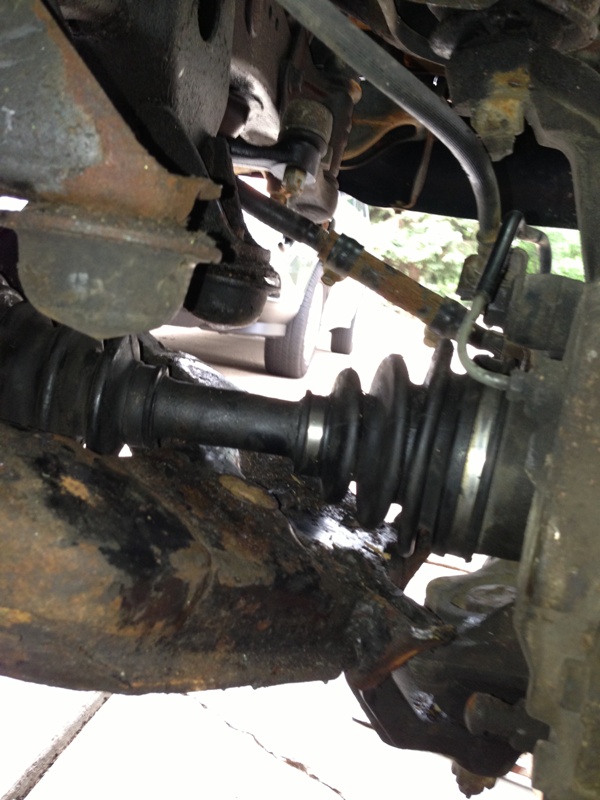

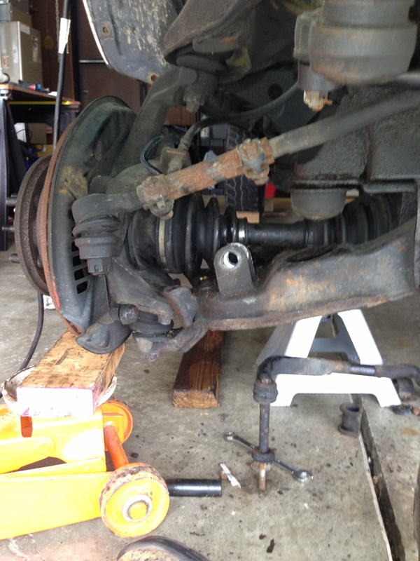

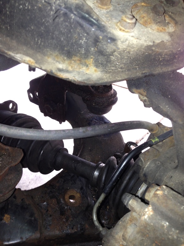

Help How do you get axel out IFS Front
Problem 1994 toyota Truck front axel removal passenger side.
Need to install newouter CV boot.
I have searched all the post on IFS axel removal and CV rebuild and replacement.
I have found some say to remove the axel you have to remove shock and swaybar end links as well as lower ball joint.
I have found some say you dont have to remove any of the above.
Well I can't get mine out. I have removed the shock and the end links, still won't clear the lower A-arm. I have turned the wheel lock to lock with no help.
I have raised the lower a arm with no help.
I dont want to drive the axel out as I am sure I would have to drive it back in and it will rip my brand new boot in doing so.
See photos and please send me the secrete to getting the thing out.
thanks

The secret[e] is just making sure the suspension is compressed as though it were sitting on the wheels. I use a jack under the rotor to lift the rotor to where the weight is just coming off the jack stand.
I have heard of someone needing to slightly lift the opposite corner to get enough suspension compression. I think that represents a bent frame, but it might be worth a try.
And no, you don't need to remove the shock absorbers or the ball joints or any part of the differential; and you don't have to use that BFH. Put it away.

You Rock Scope103, I put my front tires back on and lowered truck back down and CV axel slide right out..easy peasy!!
Got the boot kit installed and put back on...
