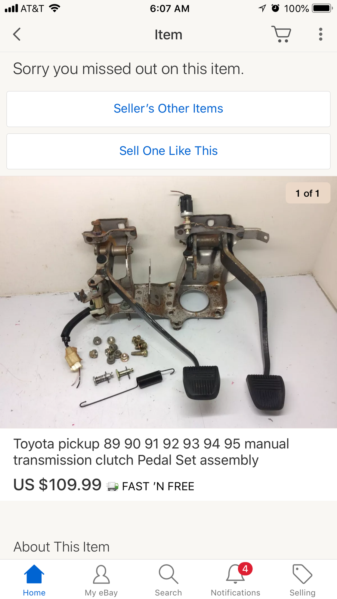

I’ve read the threads on the broken bracket problem. Mine is broke. Trying to find a used one.
Are the all the same for 89-95 trucks?
found one on eBay, says it’s right don’t see the torsion return spring for the clutch. Are the brackets the same on all models? Here is a picture. Haven’t taken mine out yet so it’s hard to compare.

this guy lists them different for 89-92 trucks and 90-92 4runners
https://www.ebay.com/itm/89-92-Toyot...4AAOSwtNFbFXhx
always thought the spring was long like shown in the pic, not a torsional spring like that would wrap around a pin...could be wrong

There’s definitely a torsion spring on clutch.

This is my first post. I’ve spent a couple hours reading the post on reinforcing the bracket. If I go to a pick-a-part I could tell if it was right. I live in the boonies. Just can’t tell if the eBay pic is right

ask the seller about the torsion spring. if it is missing you can always transfer your spring over

That picture of the spring is your 92 ??
Looks more like the stupid springs in Tacoma`s.
My 92 is at work so I can`t look

Yeah the pic of spring is mine

Found another on eBay says right year but put Vehicle info and it says part won’t fit. The v 6 is different?

So I guess the right pedal is the one for a v6 with helper spring. I pulled my old one out and welded it up.
No I found one on eBay for 100$ so I ordered it.
Gonna try the old one out first. I can always sell the one I bought. Here’s a pick of the right one
