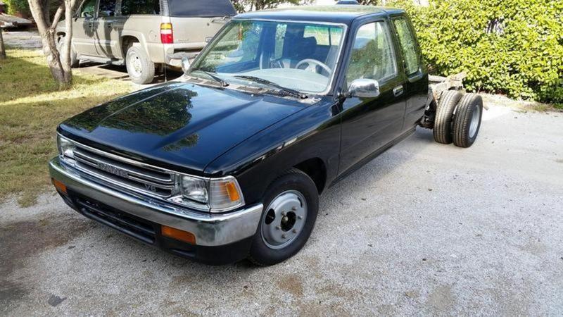

Anyone know the numbers for a long bed? It’s easy to find the total length but I’m looking for the distance from the front of the bed to the center of the axle and from the center of the axle to the trailing edge of the bed. This is for my dually project I hope to finish this year.

This is my project if it helps

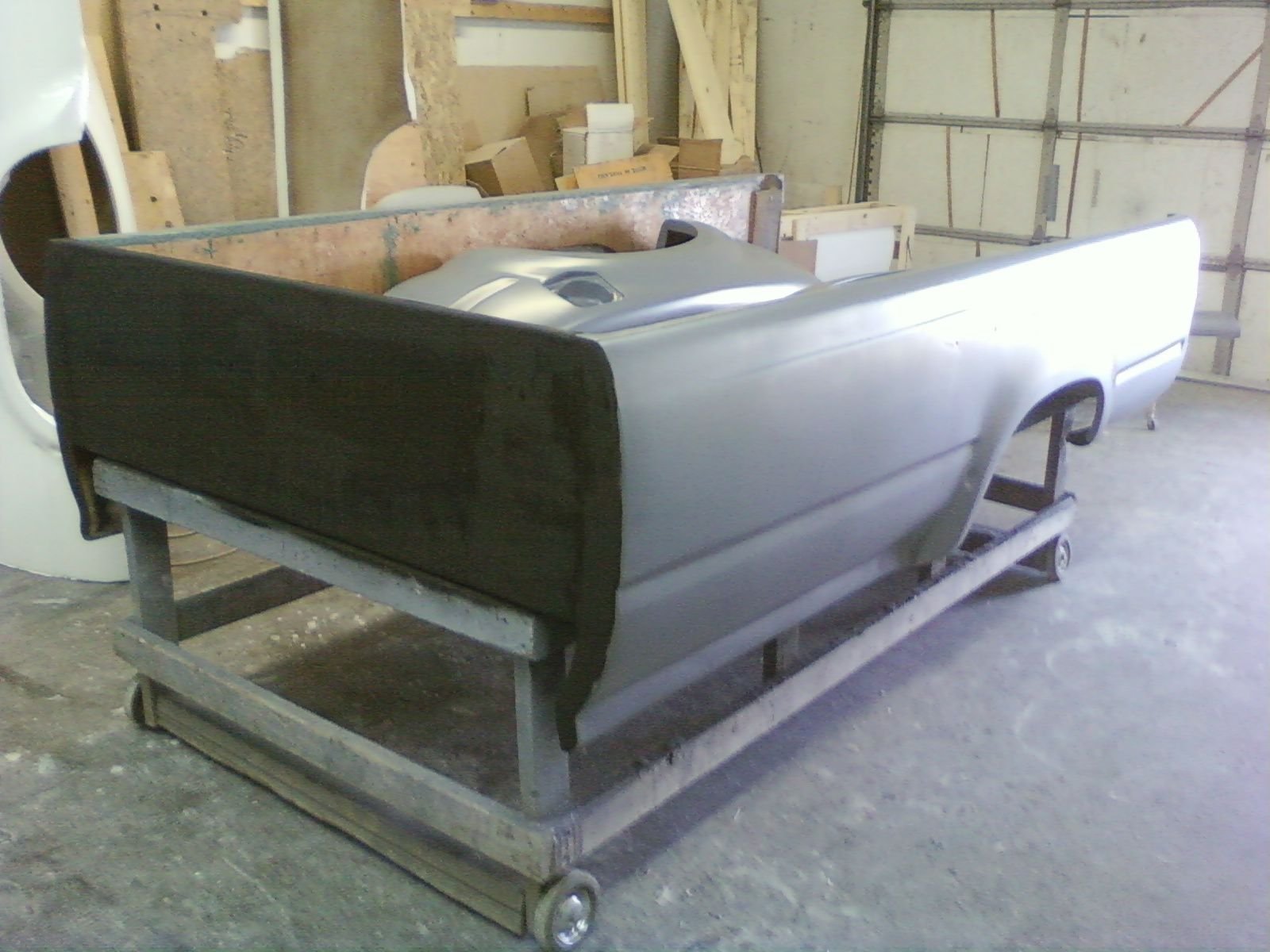

front is 26 1/2 " to the front lip of the wheel well . rear is 28"
if your interested .. I do build dually flares for this particular long bed .

Thanks for the reply. When I get home from work I'll get out my tape measure and see what I have to work with. I'm hoping that a regular long bed will work for me but I'm probably going to have to build a bed custom.
That's a nice Pic. I've had that on my computer desktop since I started this project. I'm definitely interested in some dually fenders.

I built one a few years back for a fella that had a u-haul dually ... I added 10"'s to the front so it would fit ..
he was going to send poics , but I havnt got any
