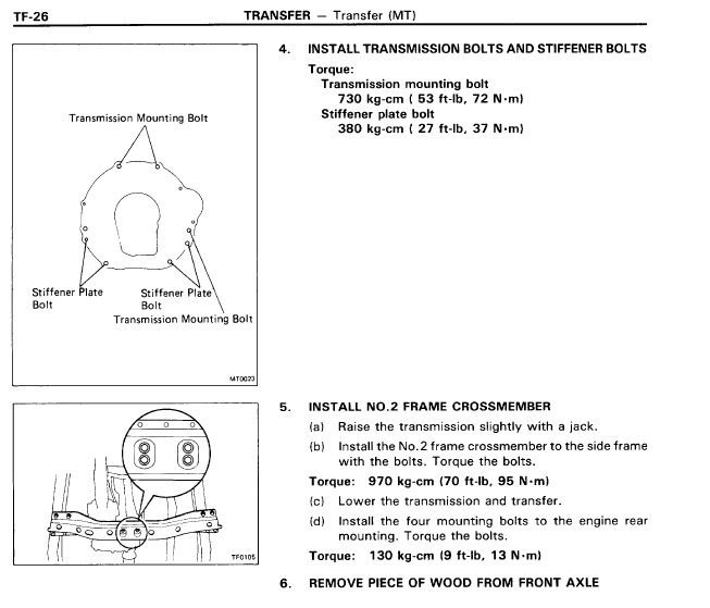

Question for anone. What are the specs for the crossmember bolts that bolt to the frame that holds on the transmission mount?

70 ft-lbs for the big ones on either side, and 9 ft-lbs for the ones in the middle.

I really needed that, thank you.
