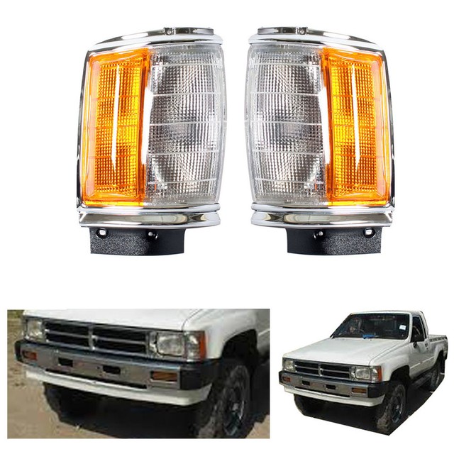

You can also get cheapo Made in Thailand corners with blinkers but both bulbs are 194's so it's not the brightest. I added LED's but eventually I'll modify them later for bigger bulbs. I plan on upgrading my bumper soon so I would have needed to relocate the blinkers eventually.
I like those corners with turn signals, but yes 194's much dimmer than the 1156's in the bumper turn signals. Eventually, however, I would like to make my corners blink with turn signals as well; I just like to see well and be seen well because of too many distracted drivers AND pedestrians (aka digital zombies) out there.
