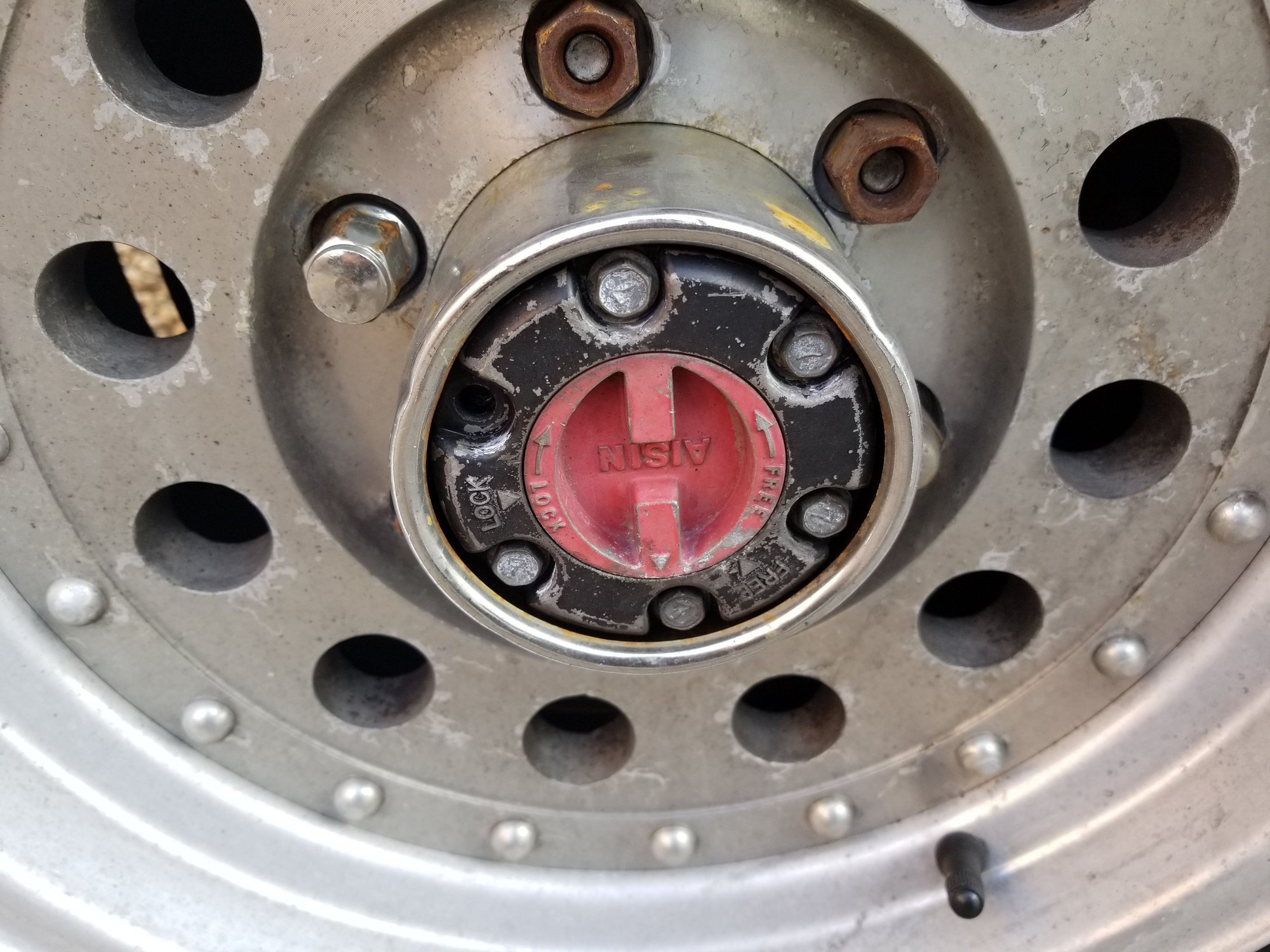

I might have missed it but I wonder could we have some transmission slippage ??
Since I have never learned to drive an Automatic I seldom think of it .
Hubs locked in ??
Hubs look to be unlocked but due to internal failure still locked

Alright here the tires the truck came with when I got it. And I looked up the gearing. It's a G292 so that means it's a 8.0" gear 4.100 ratio and and open diff right ? ASSUMING nothing has been changed. I also had the exact idea to start logging my mileage. So I will start carrying a log book and I will drive it till it starts getting empty and I will refill it till it gets full. But first I will set the correct timing even if it idles a bit high

Selectable hub isn't fully in the free position in that image. This means extra drag/load.
Tires are over sized.
Set the timing then adjust the idle. Like I explained.
Might be worth your time to learn to remove clean and reassemble those hubs.
