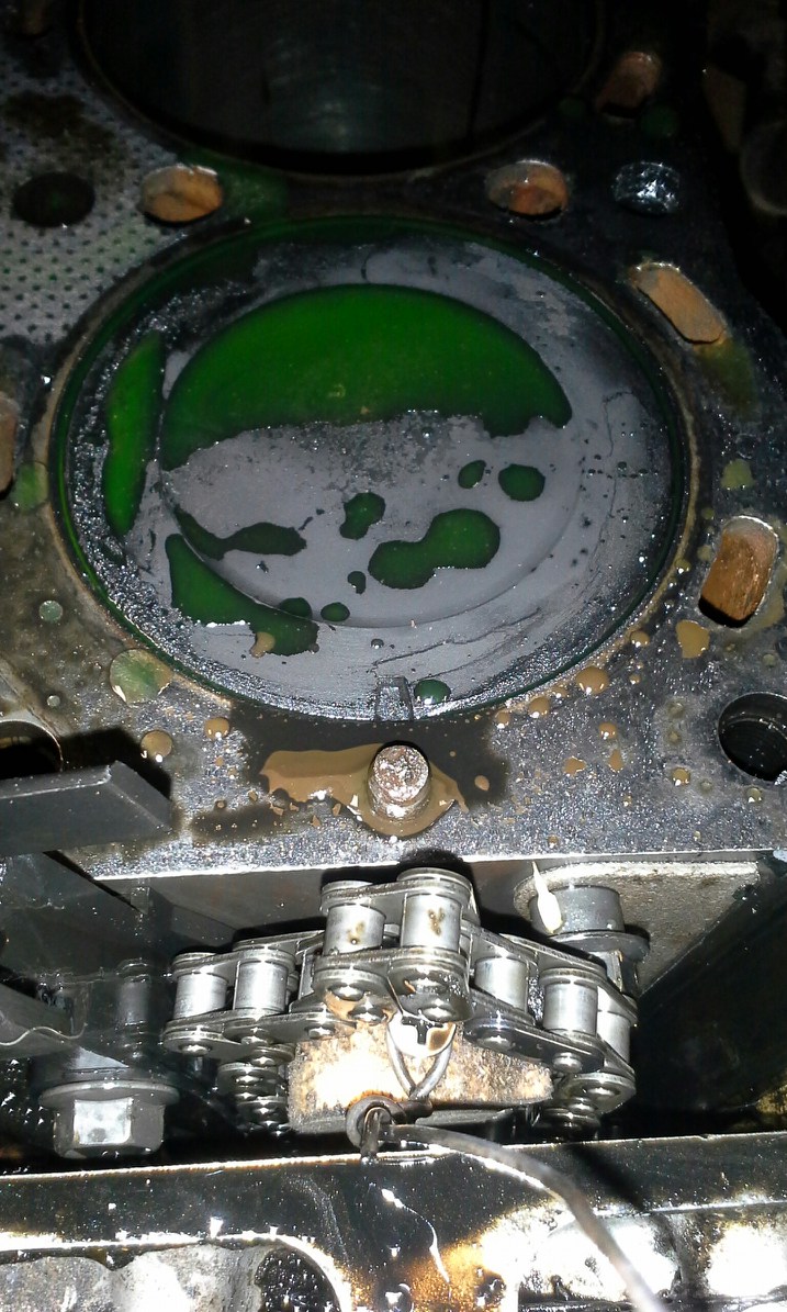

well started the tear down dont have head off but no oil and water mixture just antifreeze everywhere its in cylinders 3&4 and was pouring out exhaust most likly i need a new head right??

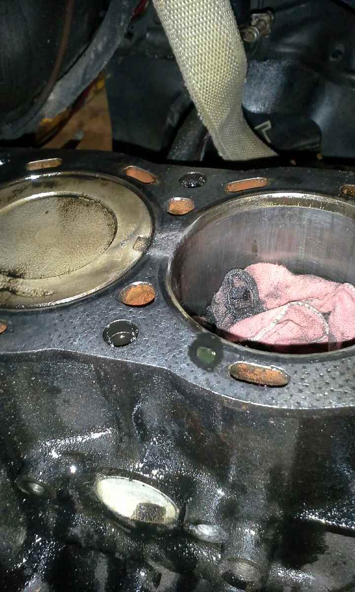

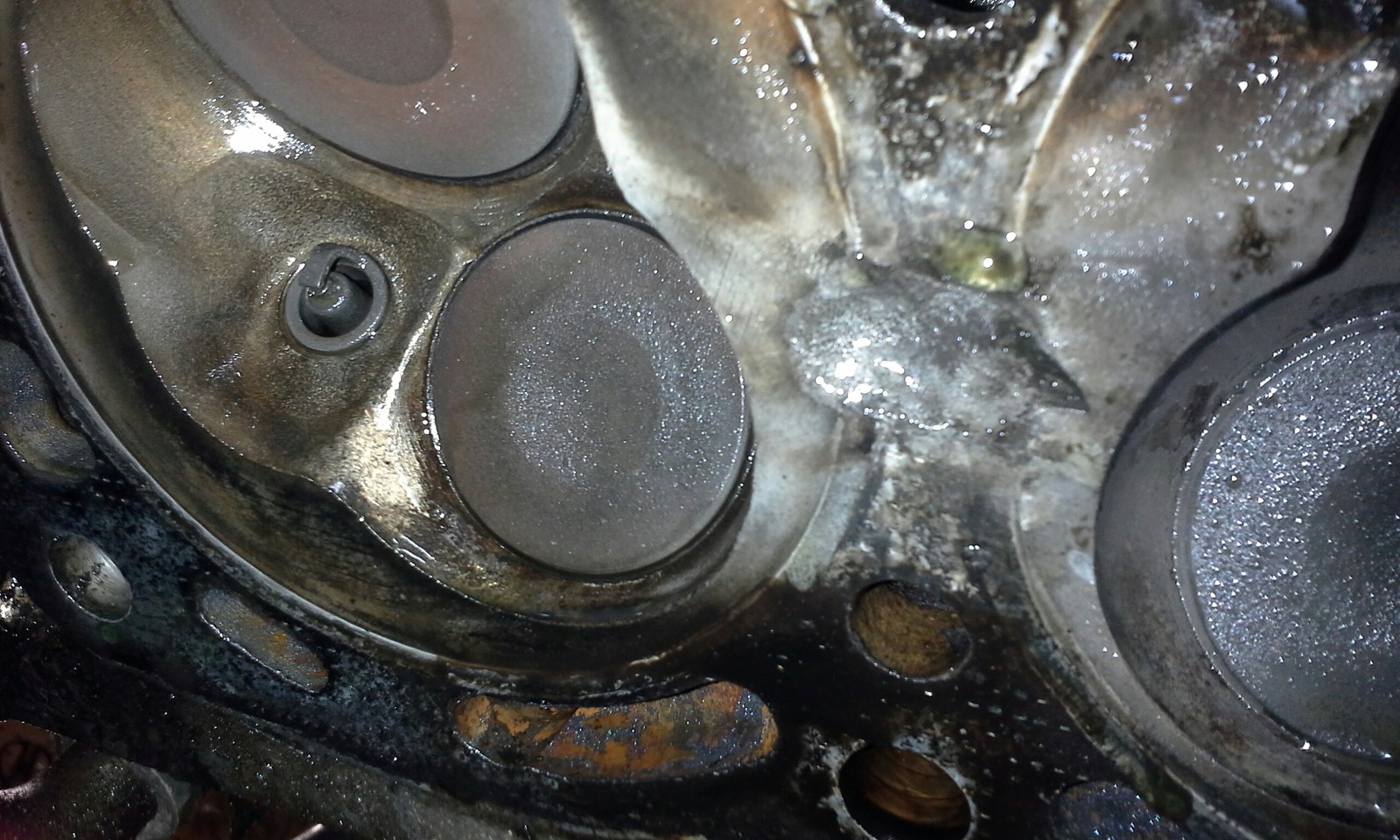

well this Is what I got a burn??? on block about 1/8 in deep and head is warped and burnt too(same depth) is pretty bad I need a new block or maybe something else I have no clue im at a rock and a hard place
Attached Thumbnails 1986 22r pickup with bad head gasket and maybe rod broke??????-20140328_205158.jpg   1986 22r pickup with bad head gasket and maybe rod broke??????-20140328_205117.jpg   1986 22r pickup with bad head gasket and maybe rod broke??????-20140328_205507.jpg
Old 03-29-2014, 05:47 PM
millball's Avatar
Join Date: Aug 2013
Location: Southern Arizona
Posts: 4,104
Received 602 Likes on 441 Posts
Wow!!
Don't think you can deck the block enough to save it.
Head is junk for sure.
Both parts might be repaired with specialist welding and machine work,
but other parts could be got cheaper for sure.
