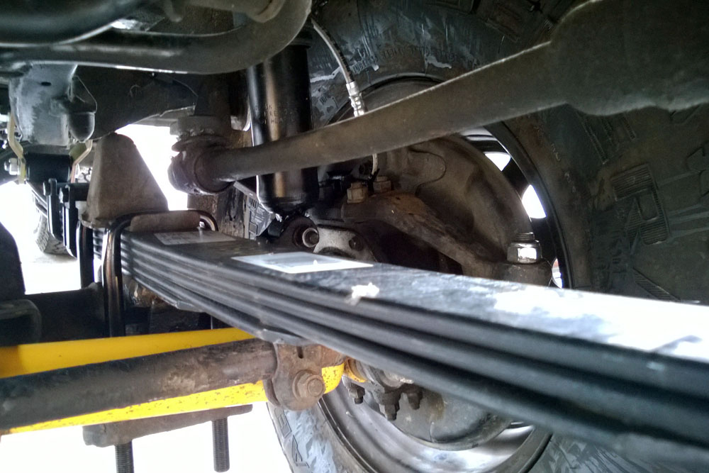

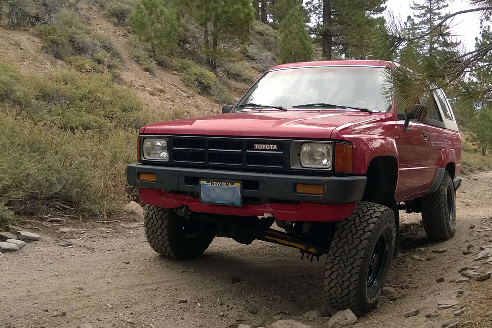

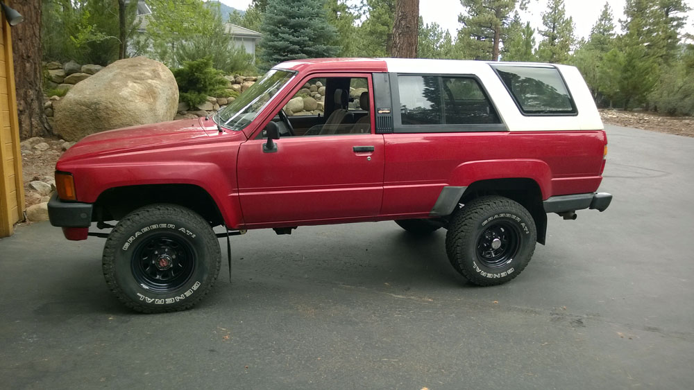

Just wanted to share some pics and thoughts I had about the new OME light/medium duty kit I recently installed on my 85 4runner. Install was decently easy- no rust issues for me. Took me a couple days as I was being diligent and taking my time with all the heavy pieces under there.
The kit truly was a direct bolt in replacement for the stock suspension. I have had no issues with the stock steering (see pics below), original brake lines would have reached just fine (I replaced mine...figured new ones were long overdue), and no driveline issues whatsoever from my limited driving thus far. The front was lifted ~2.5" while I got closer to 4" out of the rear, probably because of the saggy old springs.
The ride on road is great. Definitely firm and still rides like a leaf-sprung truck, but not nearly as harsh a ride as the stock suspension that bottomed out on the smallest of bumps. Off road looks very promising so far, but have really hardly tested it yet. Running right now without sway bars until I make up some longer ones.

3. Stock steering is fine. I was worried about having to install a drop draglink, but with the OME flattened U-bolts there are no clearance issues on my truck.

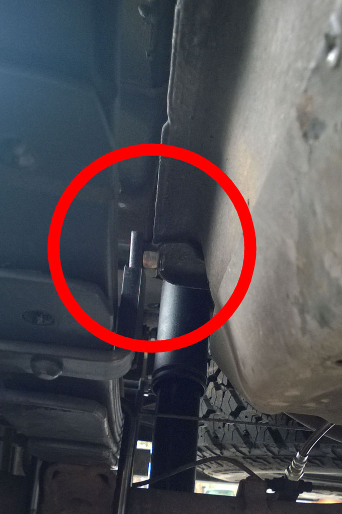

4. Passenger side rear spring- the OME spring clamp closest to the spring hanger has a bolt that sticks out and, with the suspension fully compressed, will hit the pinch weld on the gas tank. I haven't fixed this yet, but going to address this issue ASAP.

i would take a harbor freight grinder to those u-bolts that are sticking out on the bottom... maybe leave enough length to add another leaf in case you need it.
i'd be tempted to put something in there from the old spring packs.

Only thing I can add - I agree with @osv about cutting the U-bolts and, much more importantly, retorque the U-bolt nuts after you put a few miles on the truck.

Nice write-up. Thank you. I know this is an old thread, but I was curious about the wheels you are running in the pictures of this thread. The truck stands nicely.
1 ) Are those factory 3.75" backspace rims, and are those 31s?
2) The driver side front leaf you only used one of the OMEU52 flattened spring u-bolts...I assume it cleared fine on the other? Since install....have you ever had any problems with the factory drag-link with those springs?

I am going to jump in since I just did this to my 85 runner as well. I used the flattened Ubolts for the steering side and still needed the drop drag link. It seems to be hit and miss but I figured I would rather have the extra clearance vs having to always worry about binding or rubbing. To get my front springs to bolt in I had to disconnect the torque rod at the axle. I keep meaning to order the rod relocation bracket but the heavy breaking issue isnt something that bothers me personally. Although I will eventually either oder that bracket or pick it up another inch or so to run a cross over style steering setup.

1. The wheels are just standard steel aftermarket wheels, 15", 8" wide with 3.75" backspacing. Yep, they are 31" grabbers.
2. Hard to tell in the pics, but both are the flattened u bolts up front. I have plenty of clearance with the factory drag-link and I'm still running the same set up today without any problems. The draglink clearance really does seem to vary from truck to truck for some reason.
