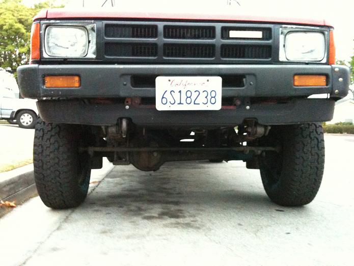

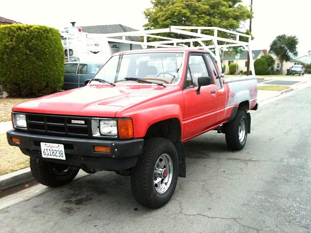

Here are a few pics of the truck

nice 85, im never a fan of chrome, but ive always loved those rims. its hard to find em in that condish, congrats.
i love my ome's i was told by multiple vendors in the area that they are the best as far as bolt on, which is why i pulled the trigger, eventually im putting on 5.5" or 6" TG shackles for the histeer.
nice quality lift, decent ride after they settle, no "snags" for me. i wish i would have went softer on the shocks maybe (like DT3000 instead of prerunners, doetsch tech fan). not the best if you are looking for a flexy sexy crawler, but great for a modest lift with no fab to use on a DD
you haul a lot of lumber??? lol
oh and ditch the track arm and the swaybar and the valance... i used a lot of choice words and time getting that track arm back on then realizing i dont even need the dang thing
