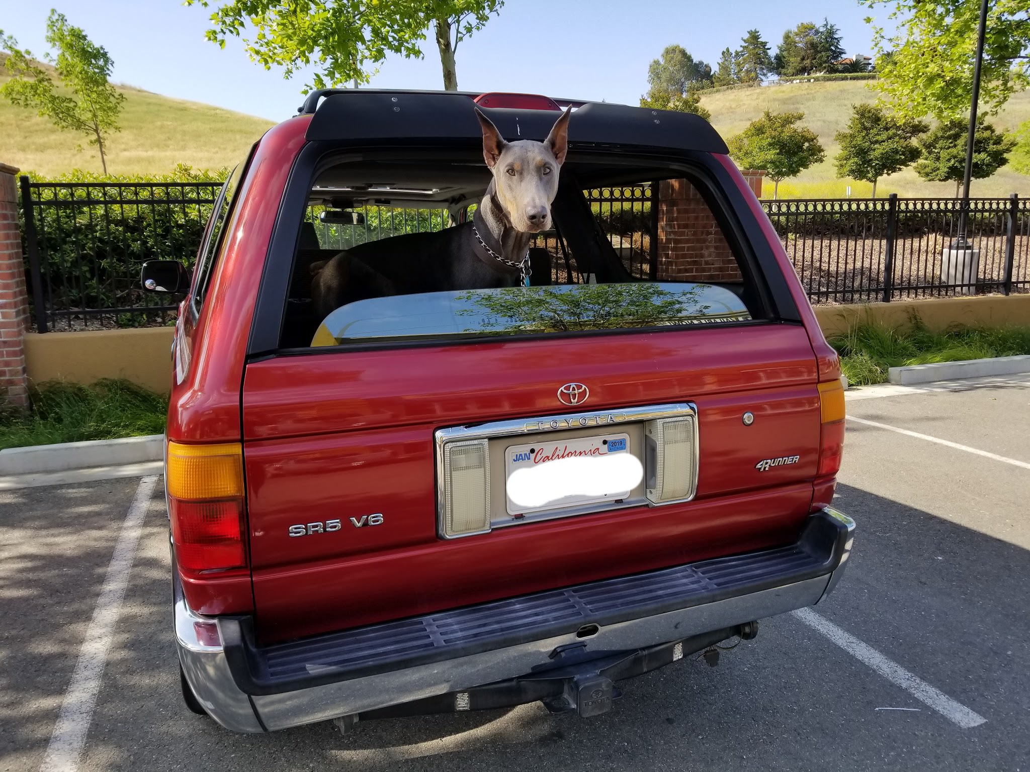

And heres the main reason we picked this up, we both have sedans and its nice to have a puppy transport machine. My wifes brother is fresh out of college and we were going to let him use it to commute short distances to work but id like to kill this vibration and at least get a new timing belt in there before blessing the borrowing.
