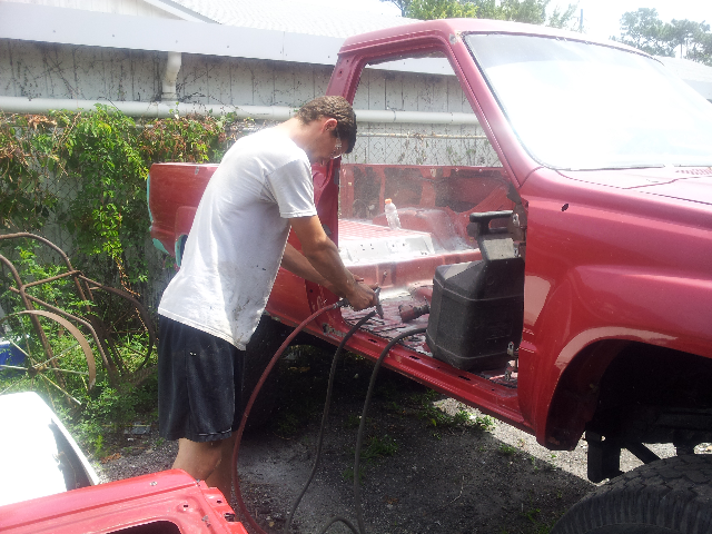

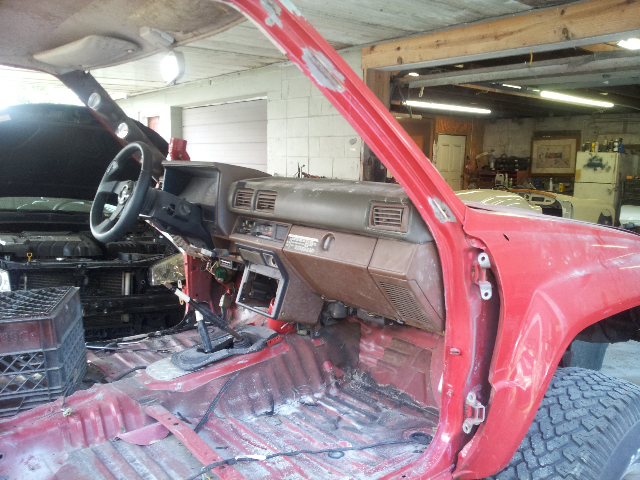

So I turned my rig into the body shop to stop all the rust.....

Old 06-19-2013, 09:11 PM
Discombobulated's Avatar
Join Date: Oct 2011
Location: Denver CO
Posts: 2,255
Received 216 Likes on 158 Posts
Dang pretty drastic, bet its gonna be sweet when it's done
