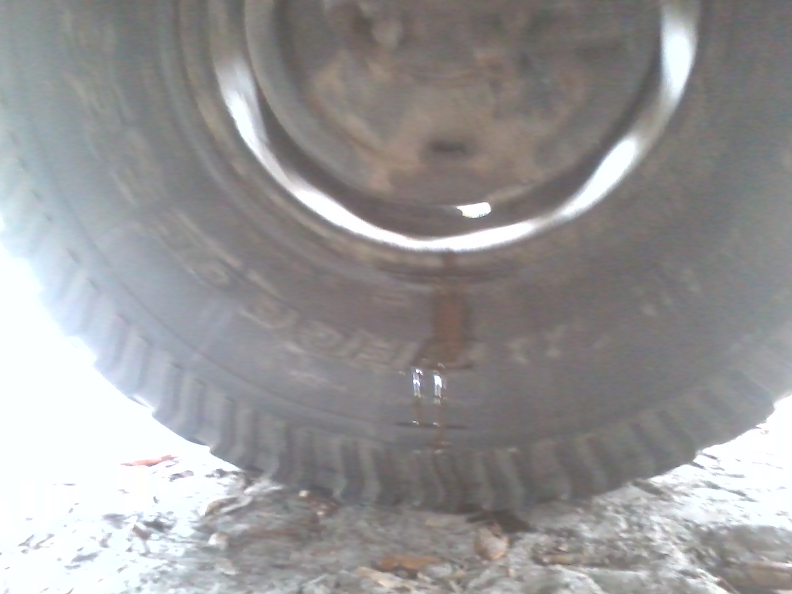

Ok so i did some wheeling last night at the local sand pits. Nothing too crazy cause im scared of breaking stuf my trucks mostly original. Just looked underneath my truck this morning and noticed a smal amount of gear oil on my rear right tire. I do not see it in any other place except for a small drop at the bottom of the brake. Im guessing its an inner axle seal? Any help would be much obliged!

Yep inner axle seal is leaking. Time for new seals and new shoes

Seems like the seals typically fail when the bearings are on their way out.

alright heard that! Hey judging by what you see in the picture would you say itd be ok to ride it like it is for a few days till parts come in? The leak spring overnight while it sat and i have maybe a quarter sized puddle of gear oil on the ground when i checked.

my neighbors mom's 4 runner has this same issue. i told her she needed to change seals and bearings. her rear brakes dont work cause of the oil and her pumpkin is about 3/4 full. this was months ago. she's still driving it around today. i told her i'd fix it for free if she bought the parts. never heard back.
you should be good.

yea i just went ahead and topped off the differential, ill just have to monitor it and see at what rate my loss is... thankfully though its only leaking out of one side for now so ill still have some rear braking.

You might want to replace the wheel cylinder while you are there and have it all apart. i just did all this today. i had napa press in the bearing and outer seal and when i got my axle back from them it was all clean. idk what they used to clean it, could be some kind of solution dip or something but ruined my wheel cylinder. when i went to bleed my brakes, one side of the cylinder inflated and i squeezed it and a milky brown liquid came out. just a heads up idk if you have already done the job or not but change the wheel cylinder especially if they look original. hopefully that marlin crawler set comes with them idk but if they do you'll be fine.

I already replaced the inner seals with beefy eco seal from marlincrawler as well as bearings o rings snap rings and outer seals. fortunately my brakes bled well. but the leaking gear oil did a helluva number on my brake pads and shoes.

the drums can be cleaned. the shoes.....not so much. use brake cleaner to clean the drums. it'll clean them in no time
