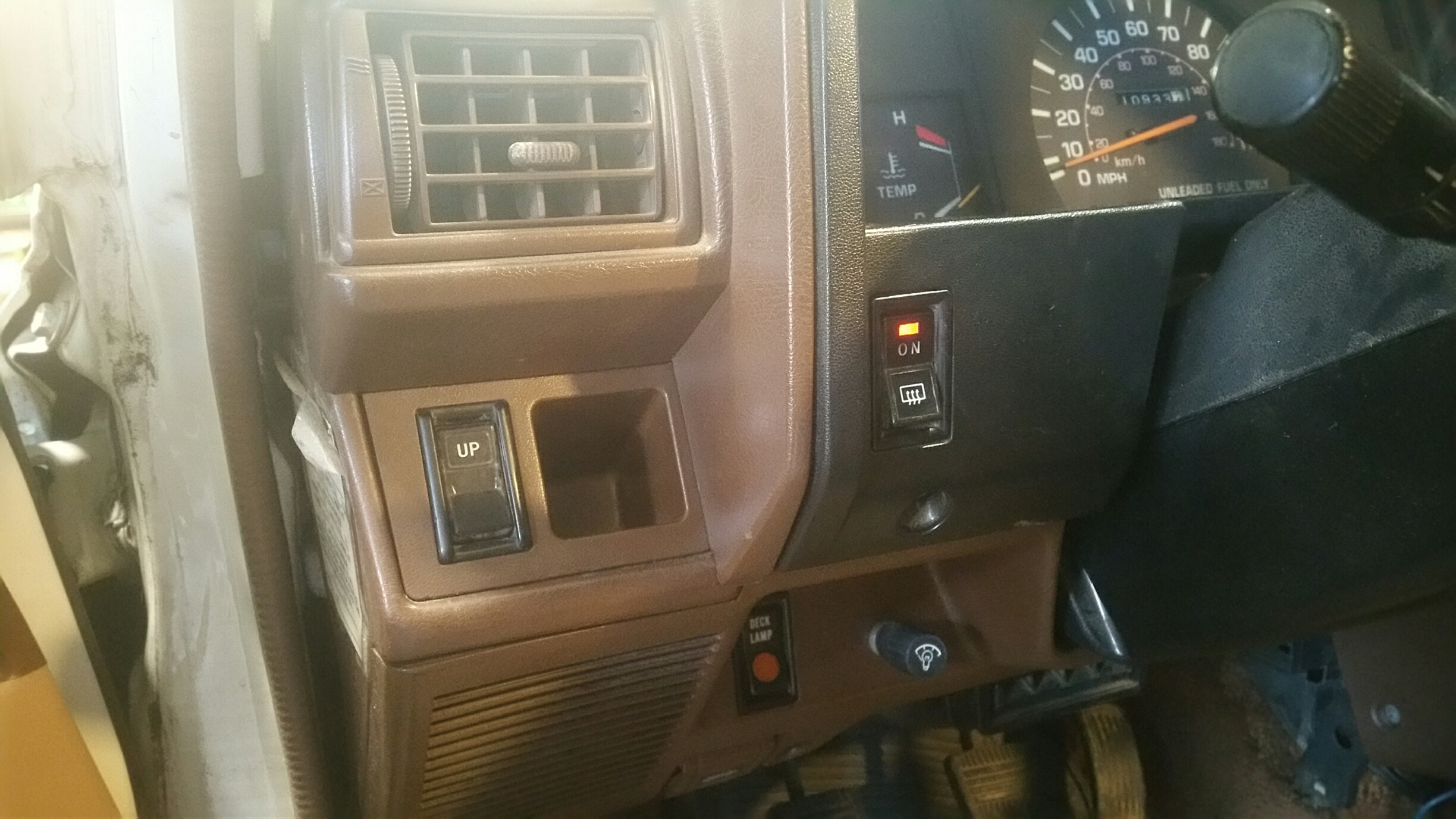

Atoyot1031 Mar 18, 2016 03:11 PM
2 Attachment(s)
Finally bought the winch & wired it up. I had a spare rear window defroster switch and located it in the clutch cancel position position as an arming switch for the winch controls. This should avert any accidental winching. The extra window switch is in the defroster location and a handy location for when I want to operate the winch.
I also picked up a 24" LED light bar and when wiring the relay, tied the trigger into the high beam circuit. It helps considerably since the original headlights are like driving with a cheap flashlight. Some day I will upgrade to H4s, until then, this will help me keep an eye out for the elk and other critters.
Attachment 104333
Attachment 104334
