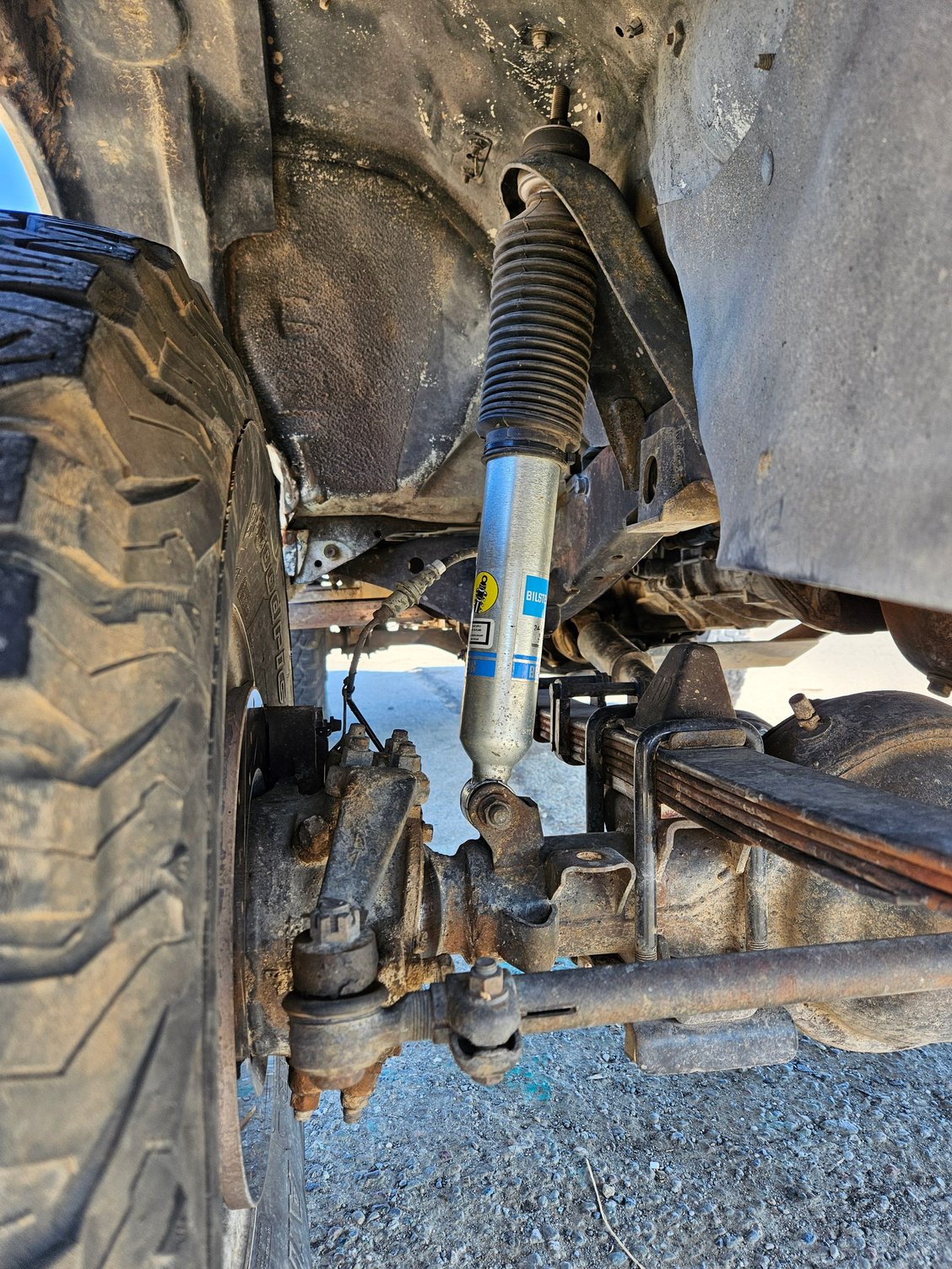

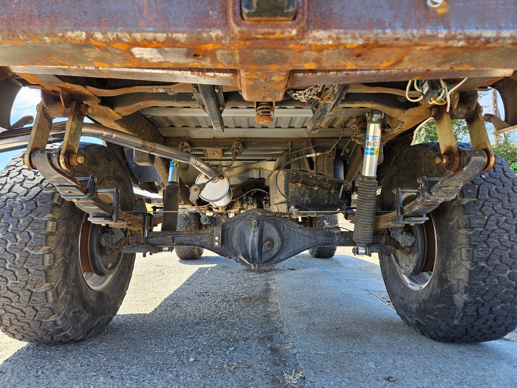

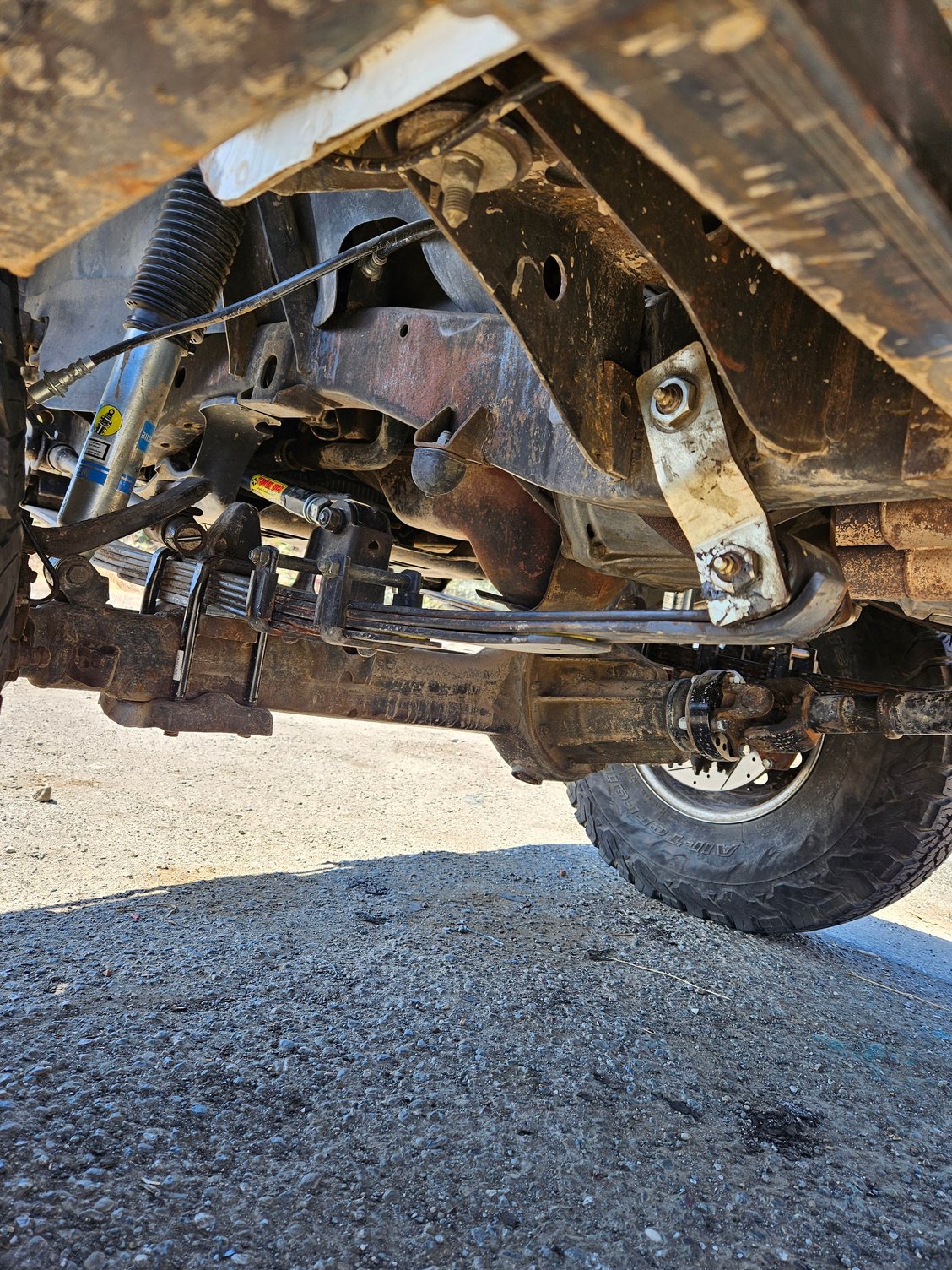

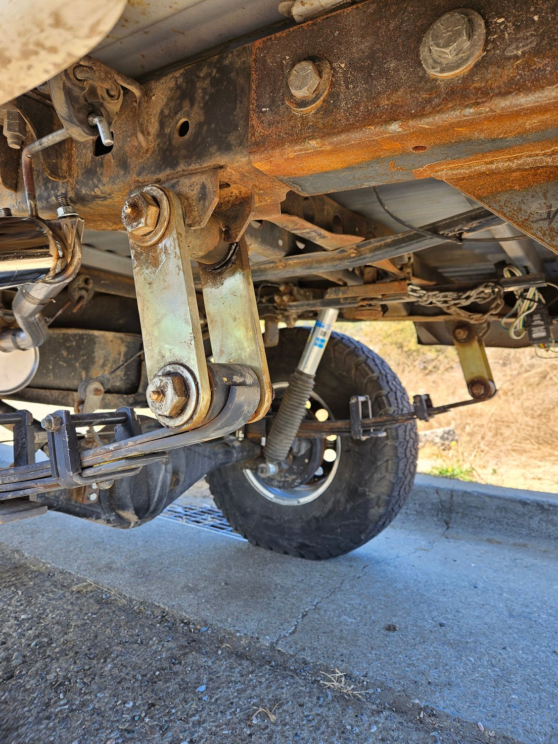

Here are some pics for reference. This is with the relocation plates up front and about 200 - 300lbs of gear in the bed (plus the shell, spare, heavy duty bumper, can swingout, and sliders). Without the gear in it, it rides a little ass end up. On very worn down 33s.

I assume you mean the distance between the bump stops (rubber mounted to the top u bolt plates) to the bump stop pads (steel plate welded to frame for the bump stops to contact at full bump)? If so, the measurements are as follows:
Front: 3.75" (from the very tip of the bump stop to the pad)
Rear: 6.5" (same as above and with the bed empty)
Remember, I have 3/8" thick axle relocation plates installed on the front. So without those, the front spacing would be about 4.125". If you are also considering using relocation plates, there are a few other factors that will be affected (steering linkage, shock alignment, drive shaft, etc). I'm happy to elaborate on those if you're considering going that route.

Installed
Installed and work very well !!! Truck feels awesome on road for a 41 year old truck. Haven’t been off road yet. Now to tackle the rears. But first I’m going reseal the front axle from the inner axle seals to the locking hubs. Getting gear oil in the hubs. Im going to order the Yukon axle seals and all the gaskets and seals for the hubs from Yotamasters.com plus a new dual stage thermostat as mine is stuck open right now. Which is better then stick ˟˟˟˟ I guess lol
