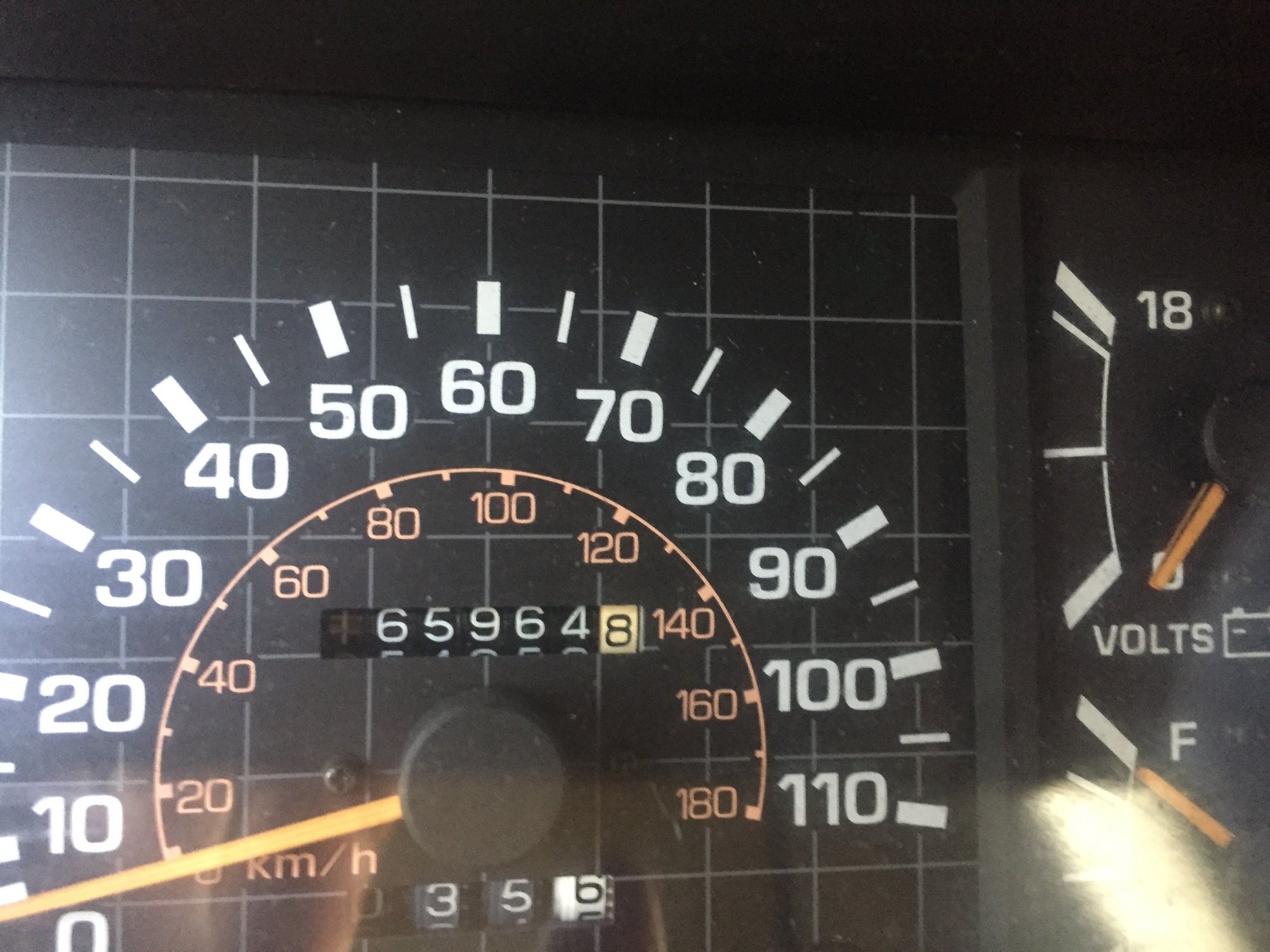

Tell us more about the rig for starters. How many miles. What the maintenance has been like.

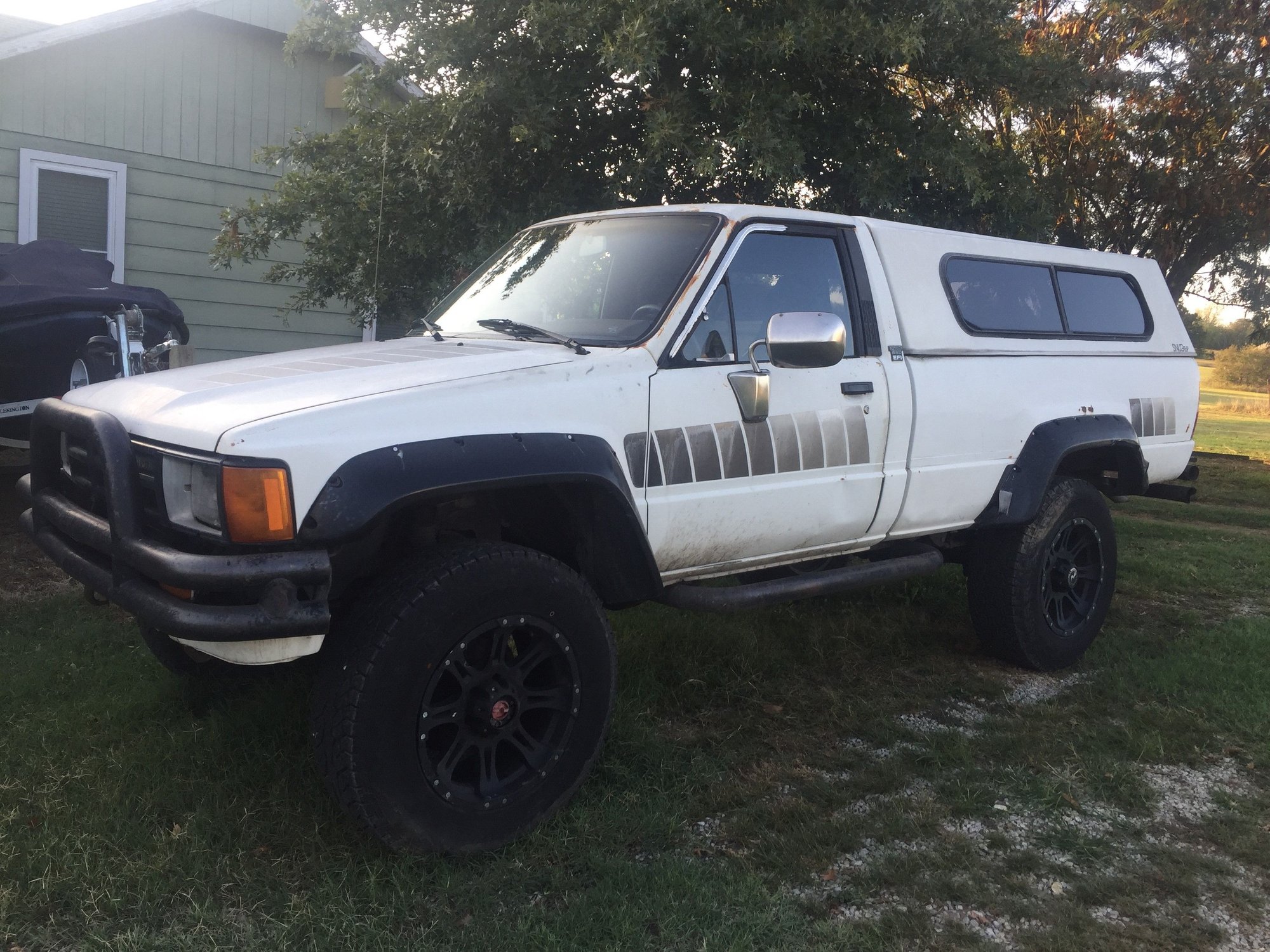

Take some pictures of your engine compartment and a few rig shot and post them up. The more you can put us in front of your rig the better we can help.

To be honest I have no clue what the maintenance has been like. I recently changed the fuel pump in the tank and screen. I looked at the fuel filter under the throttle body and it looked fairly new. I like the idea of relocating it to the fender well and since a filter isn't expensive it would be worth changing. I have changed plugs and the coil. Cap and rotor looked good. When I first got it running after shutting it off the charcoal canister would make noise. I don't know if that is a sign of something. The original ecm always has a check engine light and when the jumper is put in I do not get and codes. With the second ecm I don't have a CEL and with the jumper CEL will flash. I can take more pics of the engine compartment if that will help. I took these last night after work. I will need to rebuild the motor. Compression is 130-150 and eat burns oil. It ran like a champ when I first installed the second ecm but started cutting out on acceleration. Thanks for the reply fishguy.
