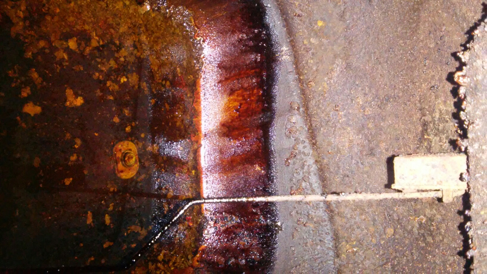

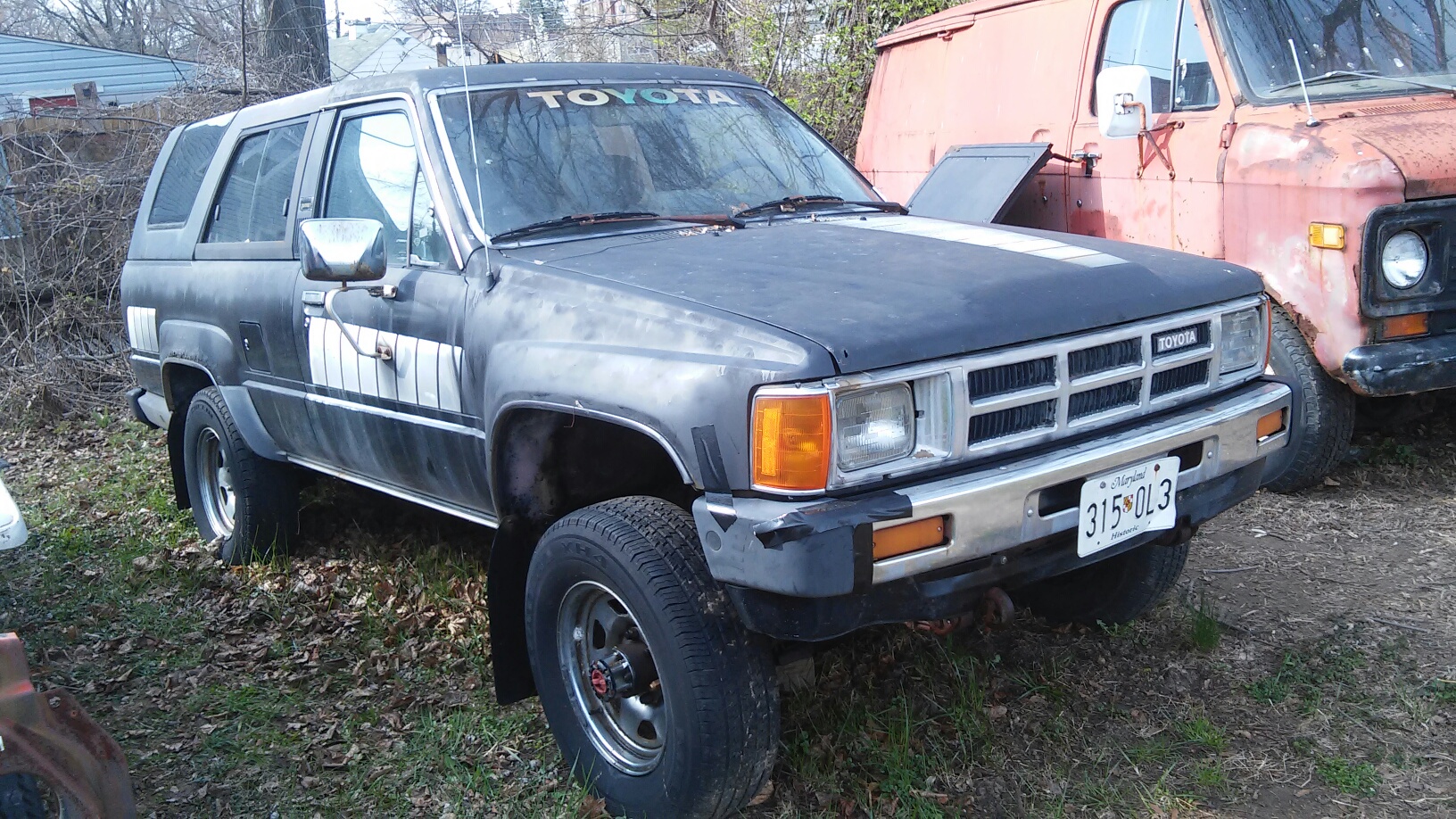

Finally got the varnish out of the fuel tank. (Acetone then vinegar) Cleaned and flushed all fuel lines, new pump. Used Stabile Fogging fluid and turned engine over 3-4 times before starting. It Started and ran really rough for about 10 minutes then settled down. Lots of rattling and deisel like sounds...seems like it needs timing guides and valve adjustments.
Let it run in the driveway for an hour. More or less it seemed to smooth out. However - lots of blue/grey smoke out of tailpipe-under load- revving it really smokes. Smells like oil. Holding at 3000 rpm gives steady blue/grey plume. Engine has 190K miles. I installed new air filter. plugs/wires cap & rotor. fresh oil/filter 10w30.
PO says it ran well when he parked it 5-6 years ago. Also says HG was done back then (estimated about 30K ago)
My quesion: Before tearing this thing down for rebuild, is there any chance oil rings are just stuck and maybe i should soak the cylinders.......if so what is the suggested concoction? Ive read that sometimes the oil rings are just gummed up from sitting along time?

Valve stem seals could be shot. Personally I would get it hot and drive it. It may clear up. I have a issue with one sitting for 10 years. I am pulling the engine and it is getting a light rebuild. Seals, rings, bearings.
