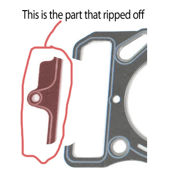

Hi guys, doing timing chain on 84 truck 22r engine and when I pulled the timing chain cover off part of the head gasket was stuck to it and ripped off... only the front part not complete piece, so the question is should I just buy a head gasket and cut the piece of that goes on top of TC cover and use that?
Don't really feel taking head of and replacing the whole head gasket, truck has 270K on it and I don't want to spend too much time and money if not necessary...
So, what do you think? Can I get away with replacing only the part that goes on top of TC cover? or am I too optimistic and it will not work? Anyone with experience with this?
Thanks

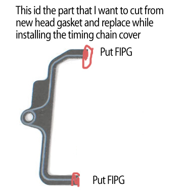

Some more info with pictures...
first picture is representing the torn part
the second picture shows what I would cut from new head gasket and replace (after cleaning the old gasket from both surfaces) while adding FIPG compound in the corners.
I don"t see why it would not work, there are no pressures from combustion/compression or any other kind of pressures in this section, its not even on top of engine block, sole purpose is to keep oil from leaking out of timing chain cover.

You may as well just put Ultra Black silicone(I believe FIPG is same) and not even worry about that piece. You will have the same results, IMO, plus it would save cost of purchasing another head gasket.
I'd have to disagree with ya there bud. That head gasket is a ill thick there for with no head gasket the timing cover will not set flush with the head. Gasket maker won't hold up to well like that IMO.
As far as the original question. You have a good idea but not very smart of one. IMO you should replace the gasket. If you do it right this time then you may hit 370 thousand. If your not gonna replace the head gasket then I highly recommend cutting out the section like you mentioned earlier. Make sure you use sealant as well. I'd almost bet that it will leak even if you would not have tore the gasket. You should always pull the head to replace the timing chain components.

I agree with you, ToyotaBoy. I was meaning to say, if he is not going to replace the head gasket entirely, he may as well just FIPG the whole thing. It's gonna have the same results, leakage.... So why buy a head gasket, cut it up, and end up with leakage...when he can just gob a tube of FIPG in there and end up with leakage...

the same thing happened to me, Californiak, when replacing my timing chain. I'm in the same boat as I did not want to pull my head and replace the gasket. I did what you are thinking about doing, except that I just re-used the piece that tore AND used black FIPG when putting it back together.
My truck runs great, but has a very small leak.
It is a very, very slight leak of oil. And I mean very slight. I wipe off the small amount of oil that leaks (about a dime's worth) every few weeks. No, it's not perfect, and I would prefer no leak at all, but my repair cleaned up major amounts of leaking around the front main seal so I did come out way ahead in my book.
So, in my not-so-expert opinion, you can "get away with it".
I agree with yotaboy and rokblox in that you SHOULD pull the head, but I think you'll be okay with doing it your way. It just won't be perfect.

Rusto, that's why I posted here, I figured this must have happened to someone already and they figured out a way to fix it without taking the head off...
I was going to do what you have done but for $15 for a new gasket I decided to cut the remaining piece off, clean both surfaces real good and cut the new gasket to fit, then apply FIPG to corners as recommended by toyota FSM...
hope I get no leaks at all, will post results when I find out

Rokblok, originally I considered your solution with FIPG but decided against because the way TC cover installs is prone to push all the silicone into the TC cavity and that could pose big problems if it ends up in oil pan...
For $15 dollars I opted for replacing the part of the head gasket that sits between the head and TC cover, plus silicone in corners...

Toyota-boy, under ideal conditions I would take the head off and do it that way. There is however the possibility of something else going wrong with taking apart 30 year old engine and it is not worth to take the risk. That part of a head gasket is not vulnerable to any stresses or pressures so if I do it right there should be no leaks at all. Well worth the $15 investment.
Will let you know if it worked.

Not only will I put FIPG on the corners of the piece you are going to add on but also make a bead of Silicone on top of the timing cover, I don't know if its just me but my timing cover is about a centimeter lower than the deck of my block.
