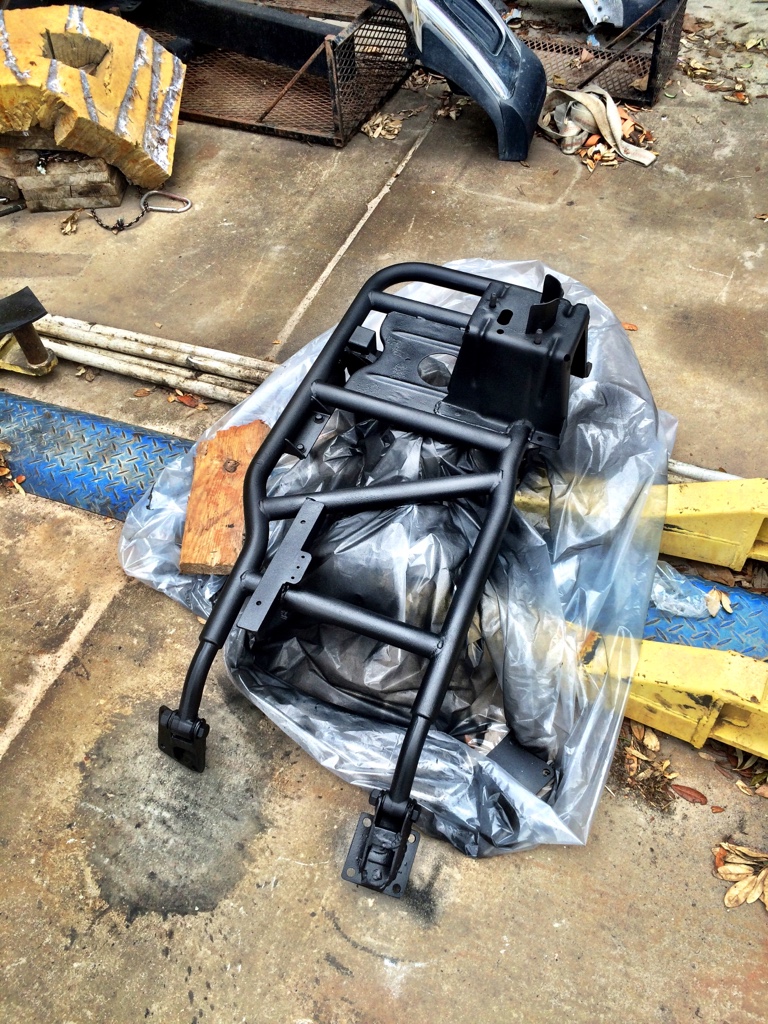

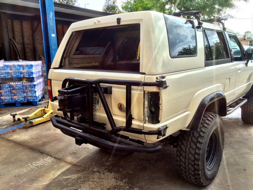

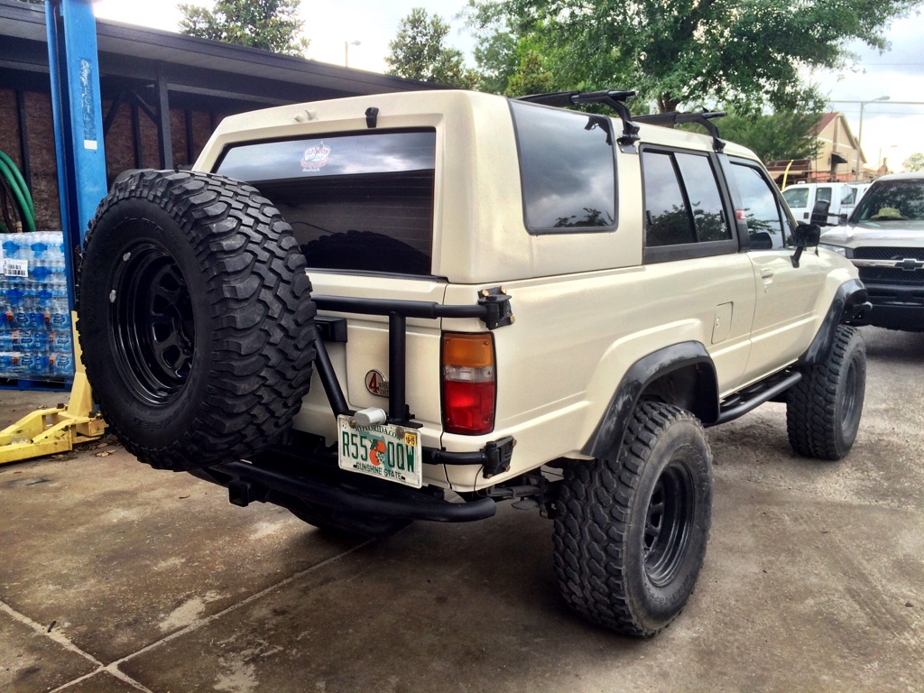

Has Anybody done a body mounted tire carrier modified to carry offroad tires? IE a newer Gen 4runner tire carrier or other makes? I'm wanting to carry a 38.5 spare without putting it on the roof.... And pics because....why not 😂 Attachment 119052
Attachment 119053

Thanks for the replies, I forgot I made this thread (get side tracked easy) and they're not duratracks they're pitbull maddogs..and I'd like to have some sort of spare and I use my cargo area to carry things...I'd use reinforcement plates and such on the inside for sure ..and I have a build thread on here "the streak" has how I cut them and all the steps and photos to go with it
I'll havta check them out, thanks guys
