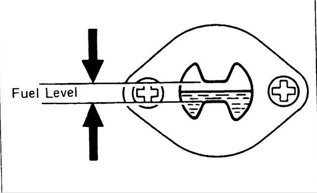

Here's what the standard fuel level is supposed to look like thru the sight glass
The manual says that on a "look check" that any level between the "tabs" is OK, but IMO dead in the center between the tabs is best.
You'll have to take the top of the carb off to access the float & bend the tab that contacts the shut-ff valve in order to change the fuel height level.
Here is the procedure & specs, pages 4-20 & 4-21.
