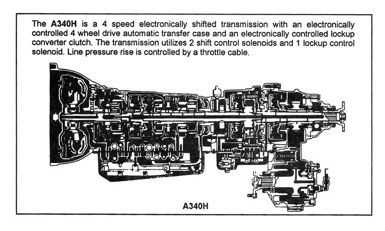

4runnerx3 Aug 8, 2015 05:54 PM
6 Attachment(s)
Attachment 119186
Attachment 119188
Attachment 119190
The power button changes shift rpms. It revs a little higher before changing gears with the power button on. Does the OD light blink? If so you have transmission codes. The shift solenoids work it pairs on and off combinations.
In "D"
1st gear- solenoid 1 on, solenoid 2 off
2nd gear- solenoid 1 on, solenoid 2 on
3rd gear- solenoid 1 off, solenoid 2 on
OD- solenoid 1 off, solenoid 2 off
