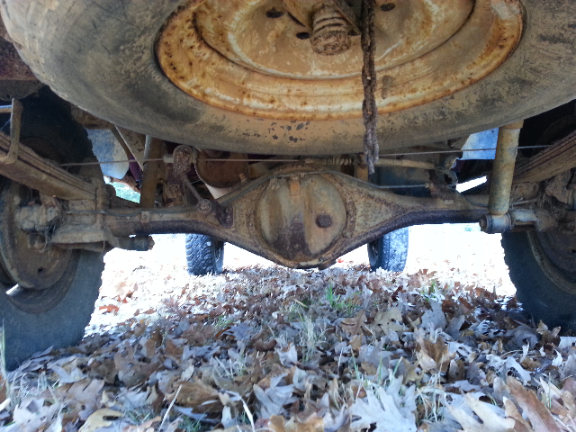

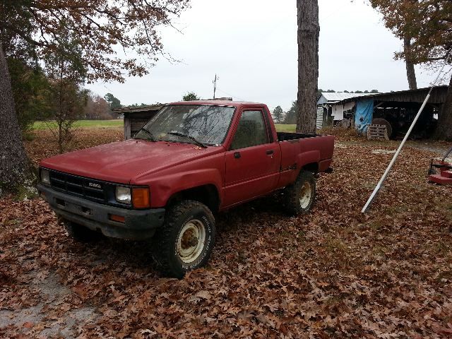

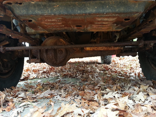

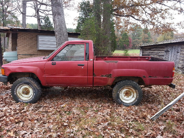

What state are you in? That truck looks familiar, as well as the scenery. Tennessee or Georgia?

Oh yeah?...my yard in Virginia...live on a farm.
