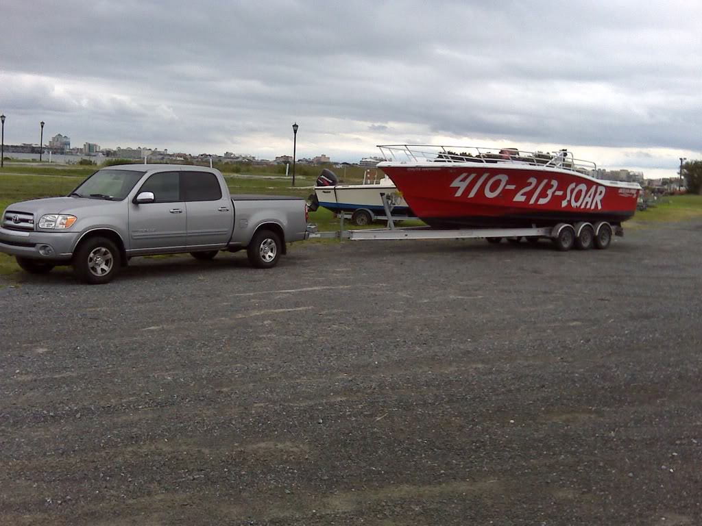

I've towed this 31' OceanPro parasail boat about 125miles from New Jersey Ocean City, MD with my 2005 Tundra DC. The boat weighs in at roughly 13,000lbs and my Tundra has a 4.7L V8 with electric brakes and weighs about 6,500lbs. The way I look at it my 1983 is a 2.4L 4 banger weighing in at about 3,000lbs which is about half in both departments. So It should be able to tow about 7,500lbs...
JUUUUST KIDDING! Don't try towing 7,500lbs with your truck - you'd likely blow out your rears if you don't burn up your clutch and destroy your tranny first! All kidding aside, I wouldn't think twice about towing 2,000 with my 83. If I recall correctly, the first gen 4WD trucks were advertised as having a 3/4 ton payload capacity so the towing capacity should be nearly double that.
Pretty much anything can tow anything (Like the Tundra space shuttle commercial), it's just a matter of how well it can tow it and for how long. I abuse the piss out of my Trunda and it actually hauled that boat really well considering I nearly doubled the towing capacity. Was it smart? Probably not, but we had business to do and I liked the fact that my Tundra could tow the same boat that blew out the rear ends of a Nissan Titan and a Ford F150 on a simple tow across town!
