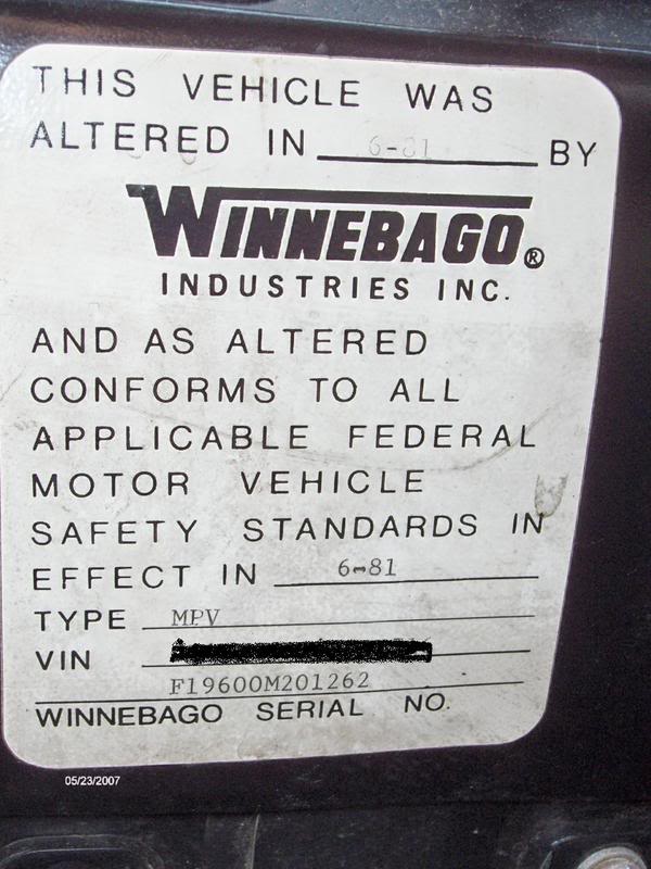

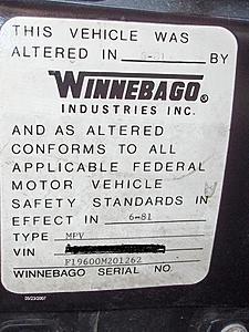

do you have the winnebago conversion sticker?
usually found under the dash similar to the label you show above.
this is the tag from my 81 Trekker

I haven’t seen that sticker anywhere. Mine is a Canadian model. Apparently they were all fabricated in Calgary by the Hennessey dealership
